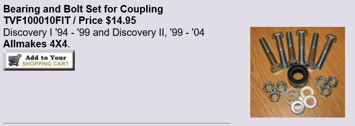

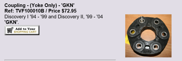

... So 2 options; Convert the rear drive shaft to a (2) U-joint shaft, or get a NEW GKN Rotoflex. If you choose the rotoflex... Trust me, you ONLY want a NEW GKN (#TVF100010G Made in Germany). Good Luck!
What is the average price for the GKN's? Unless I'm looking at the wrong part, I've seen them online for $120 to $150.
Old Mar 13, 2017 | 10:43 AM
OverRover's Avatar
Posts: 2,514
Likes: 656
Trevor at Rovahfarm (Alexander, AR) sells the GKN and Bolt kit separately for $87.90 plus shipping. > RovahFarm for all your new Land Rover Parts and Accessories
I think L8 might have the GKN for about the same price.
