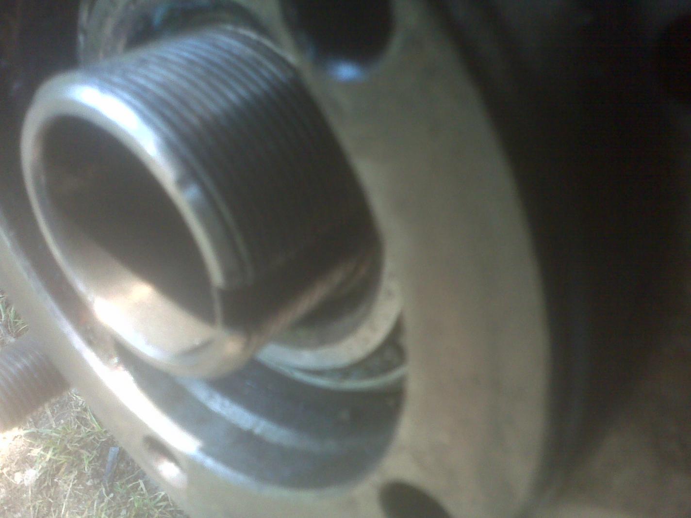

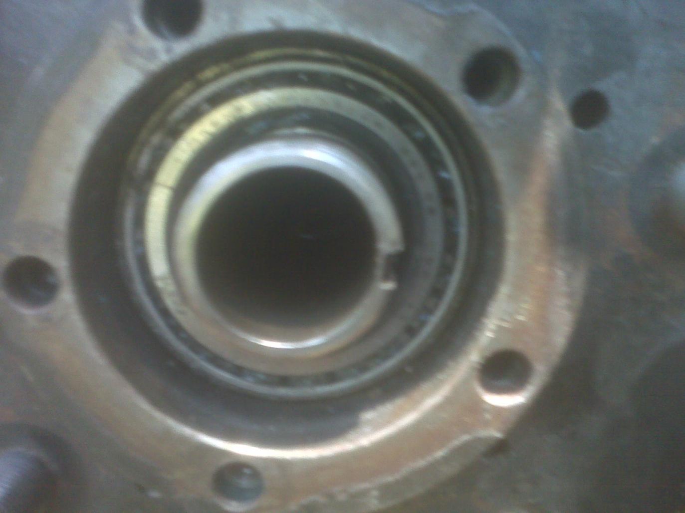

ok i got it on but the stud is totally differnt from the one i took off... it got a cut line instead flat piece so i got get the new washers for it or did paul send me the wrong part

monett mo ... i got hold of him and he told me if he had the washer he whould send them so i cant find a washer for this stud....

The spacer should go on, then the inner nut, before you install the locking washer.
Also, I can't see a bit of grease on the bearings. The bearings need to be well packed (grease between all the rollers) and the space between them about 1/2 full of grease before installing the hub.
