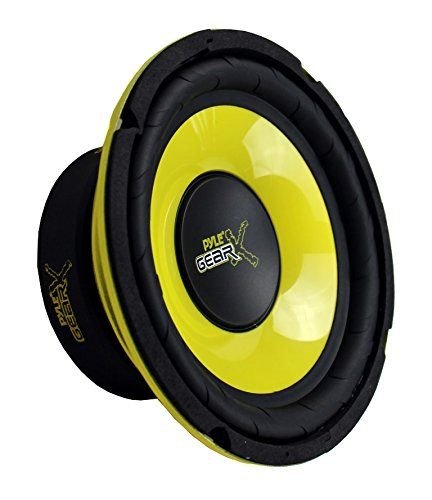

For $23 a pair I installed two years ago the Pyle PLG64 300W mid bass subwoofers after I blew out the stock subs.
They are good but not 'audiophile-wise' extremely great. I got what I paid for...
