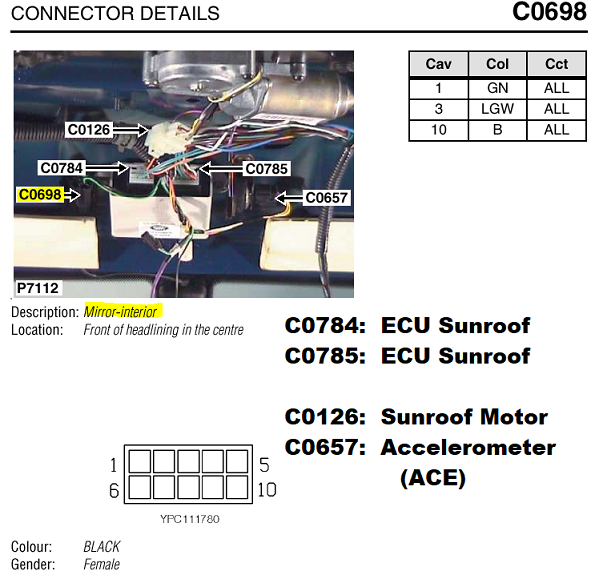

I had my windshield replaced earlier today and, in the process, discovered that the rear-view mirror wasn't plugged into anything (I have tinted windows all the way around which is probably why I never noticed it not changing). However, once re-assembly began, I discovered that the connector on the mirror doesn't match any of the three connectors I found under the headliner (not terribly surprising considering my Disco is a Frankenstein). I know the foam-covered connector is for ACE, but which of the other two is for the mirror? I plan on replacing the factory connectors with bullet connectors when I fix the headliner in a few weeks....thanks in advance, M

Have at it...…..

Excellent! Thanks, M
