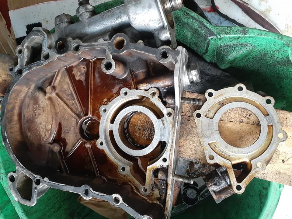

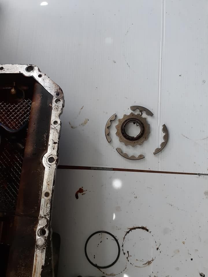

Oil changes have been routine, always used Rotella 15W 40 with a good filter(not Fram). I was noticing that upon start up the oil pressure took a little bit longer to rise. I never checked it with a gauge though ( yeah yeah, I know lol). Then I was noticing that sometimes at idle while driving I could hear valve train "tapping sounds" from near the driver side valve cover. I though that it may have been an exhaust leak due to the fact of recently replacing the cats but I was wrong. Drove it to work, went to leave and no bueno. I started it, zero pressure, revved it just a little and valve train noise got super loud and I turned it off. Long story short, I pulled the oil pump, it cracked in 4 spots. It looks like the front cover is fine though, I'll be cleaning it and taking measurements later. I haven't checked clearances on the crank yet either, it's good to know that they're "bullet proof" though. I still need to pull the valve cover(s) too, I have yet to inspect in there. On the cylinder liners, my plan was to buy the tophats and then eventually take the block and heads to a machine shop. That is down the road though. I'll know more by end of day tomorrow, I just need the free time to get to wrench on it.

My guess is your pump initially cracked in one place, you saw and heard that drop in oil pressure, then it cracked in 4 places, that is when you got the zero pressure situation. I doubt you have any significant wear not associated with normal mileage.

That's what I'm thinking too. I checked everything when I did the Head Gasket Replacement 80k ago. I guess I should have done the oil pump, timing chain gears back then as well, oh well. Does anyone know off hand what the replacement part # is for the Oil Pressure Relief valve rebuild kit? I cannot find one online...... I definitely want to replace those bolts on the front plate....
