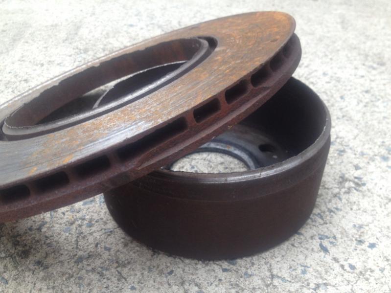

And here is an example of what can happen if rotors are abused.
Recommendations for a good non drilled or slotted front brake rotor-image-1312960019.jpg
It's hard to see but check out how thin the face of the rotor on top in the pic is. And the rotor was separated from its hub while in service, not after being removed. The guy drove the truck like this for several weeks at least. It was installed by a Land Rover dealer several years prior so I assume it was a "genuine" part.
Attachment 18268
That looks like something wore into the hat until the material got so thin that the rotor cracked off, and all that ensues. Maybe the pad wasn't installed correctly?
Attachment 18268
Same thing happened to my wife while she was driving earlier this month.
