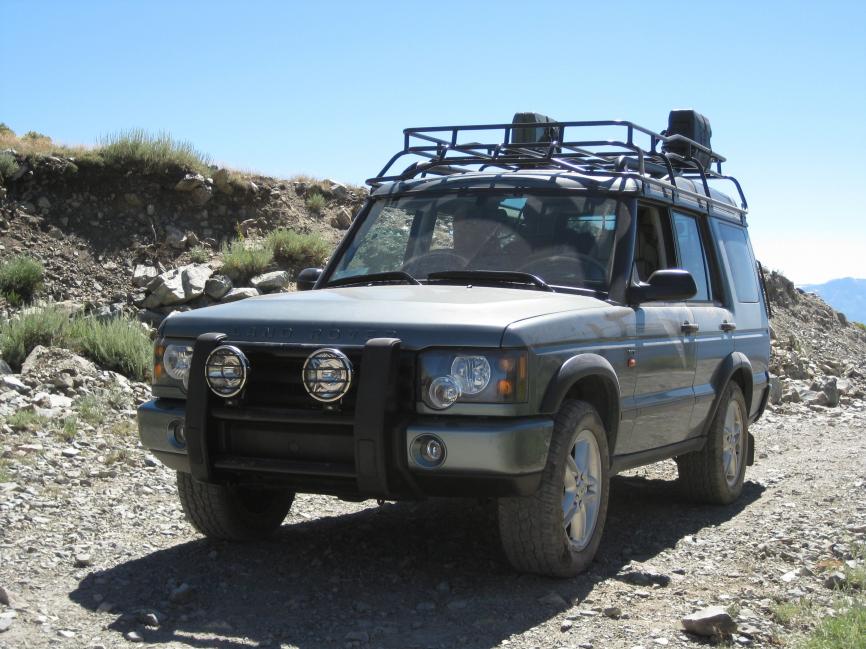

Dave, if you are talking about removing the rectangular cross bar from the front of your frame, that is a huge mistake, you will be leaving a very weak spot and your frame can/will twist.
As for Jate rings, only use the original, not any of the after market ones that will and do fail. When using them you will still need to notch the bumper to be able to access them.
As for the factory tie down loops, that is just what they are and they will not take too much pulling. I had a friend try to pull out a Rover from the rear tie down, it came off and went thru his windshield.

Hi DM- No, I'm not talking about removing the cross member at the end of the frame, but the brush bar on the front bumper (see picture). Removing it leaves holes in the bumper mesh, through which I can access the frame. I'd like to put Jate rings there, just don't know if there is a standard size that fits there.
Also, there are two, very solid round holes in on the bottom of the brush bar. Do you think the brush bar's mounting is substantial enough to use these as recovery points? Perhaps a couple of d-ring shackles when off-road? The holes are in the 1/4+ inch steel framing of the brush bar, with plenty of width between them and the outside edge.
