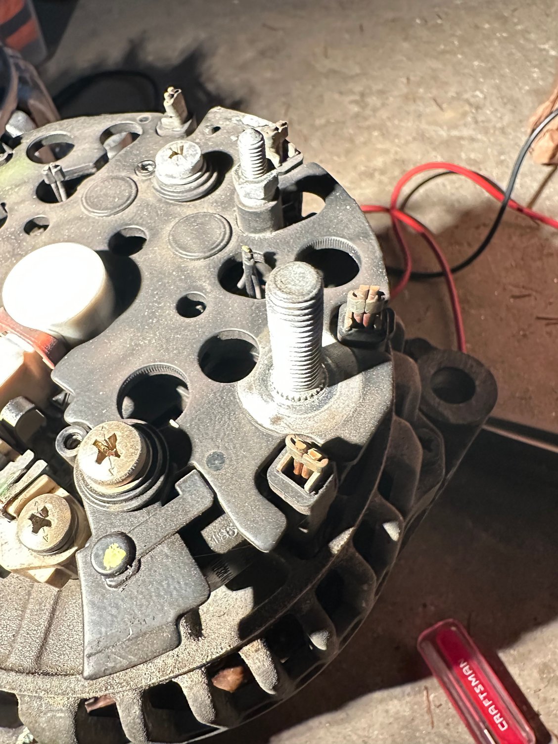

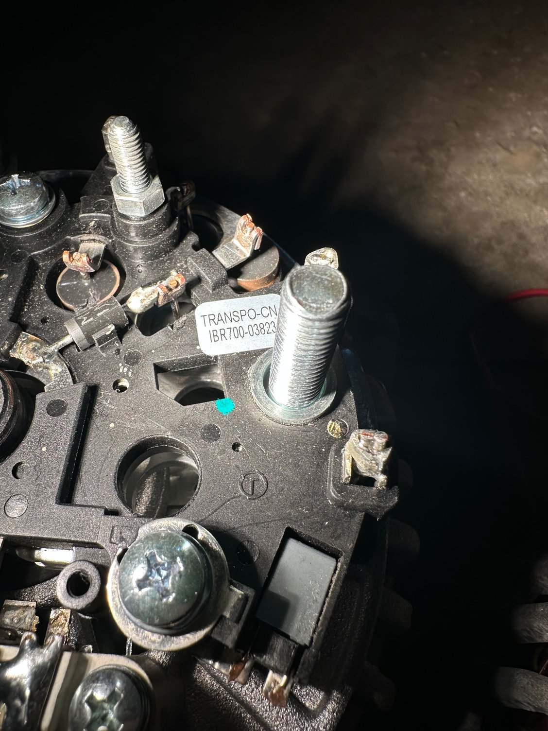

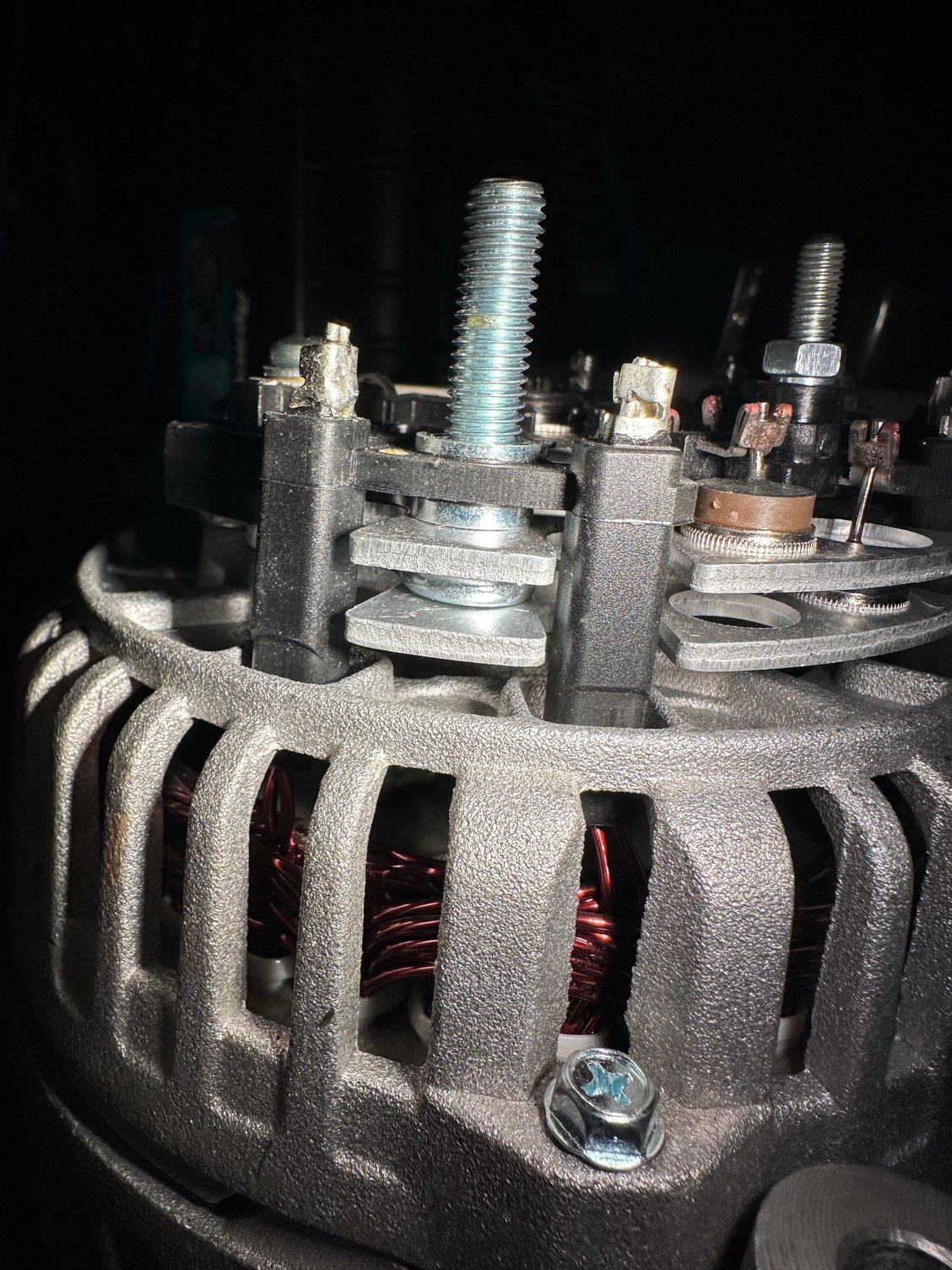

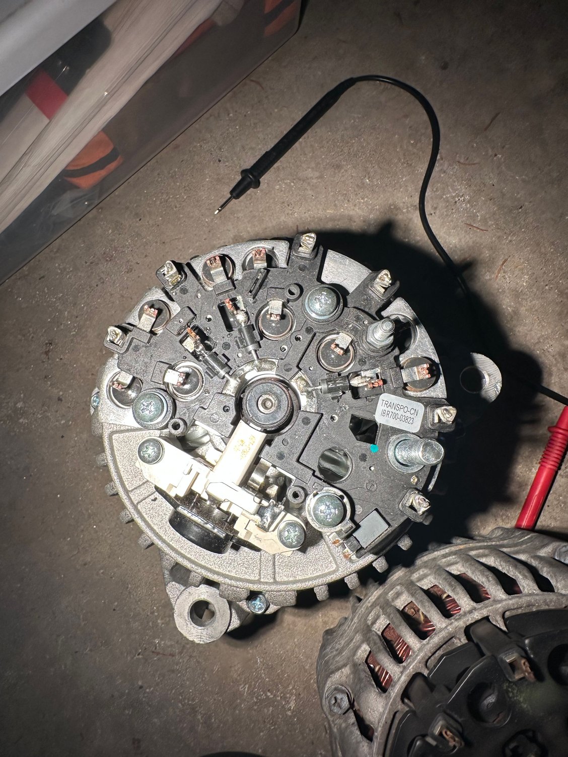

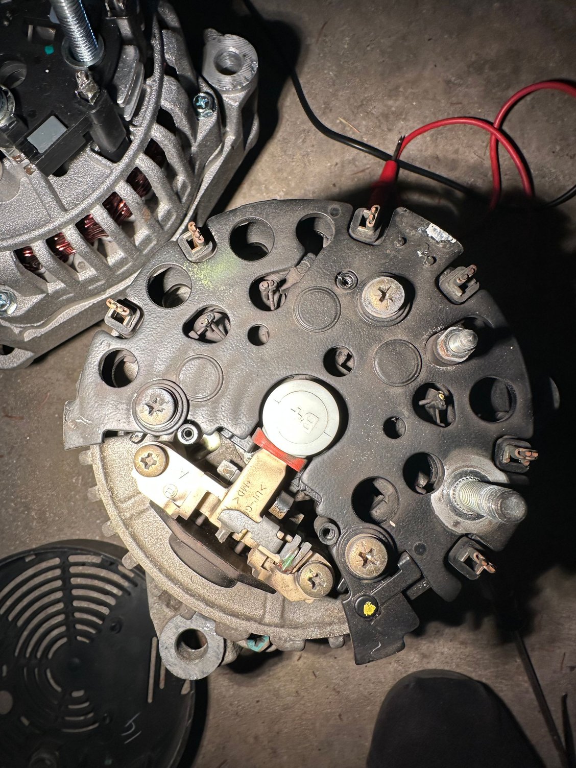

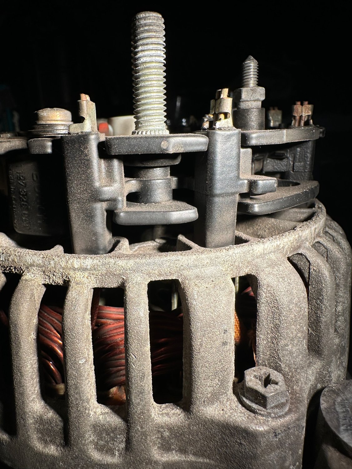

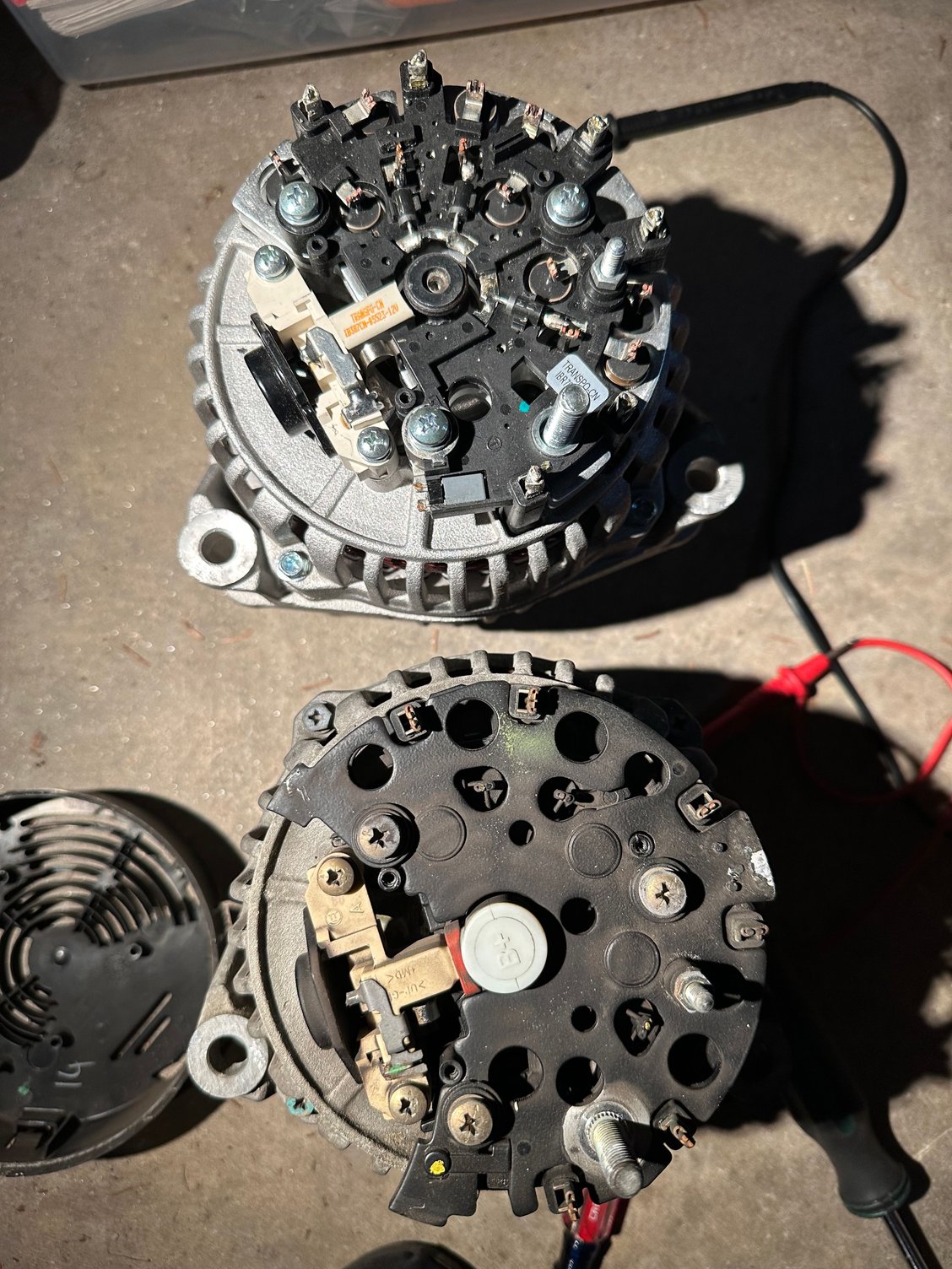

Received an eBay, 150A, made in China alternator for the D2 this week that was very poorly packaged and dead on arrival.
Nevertheless, I wanted to share some photos to compare my OEM Bosch 130A alternator to the no-name made in China version (this is not the Made in China Bosch). Figured this may be of use to someone since the physical differences look interesting and I haven’t seen anyone discuss them otherwise. Definitely would AVOID these made in China alternators, despite the cheap price.
I determined it was dead after installing it, realizing the battery was discharging while running, and confirmed no output with a multimeter.
Photos taken with the rear plastic covers off.
Made in China top, Bosch OEM bottom
Made in China
Made in China
OEM
OEM
Made in China - The main positive connector is a free floating screw that doesn’t seem to positively connect unlike the OEM Bosch
Bosch OEM - Solidly mounted screw without play
Another view of made in China version
