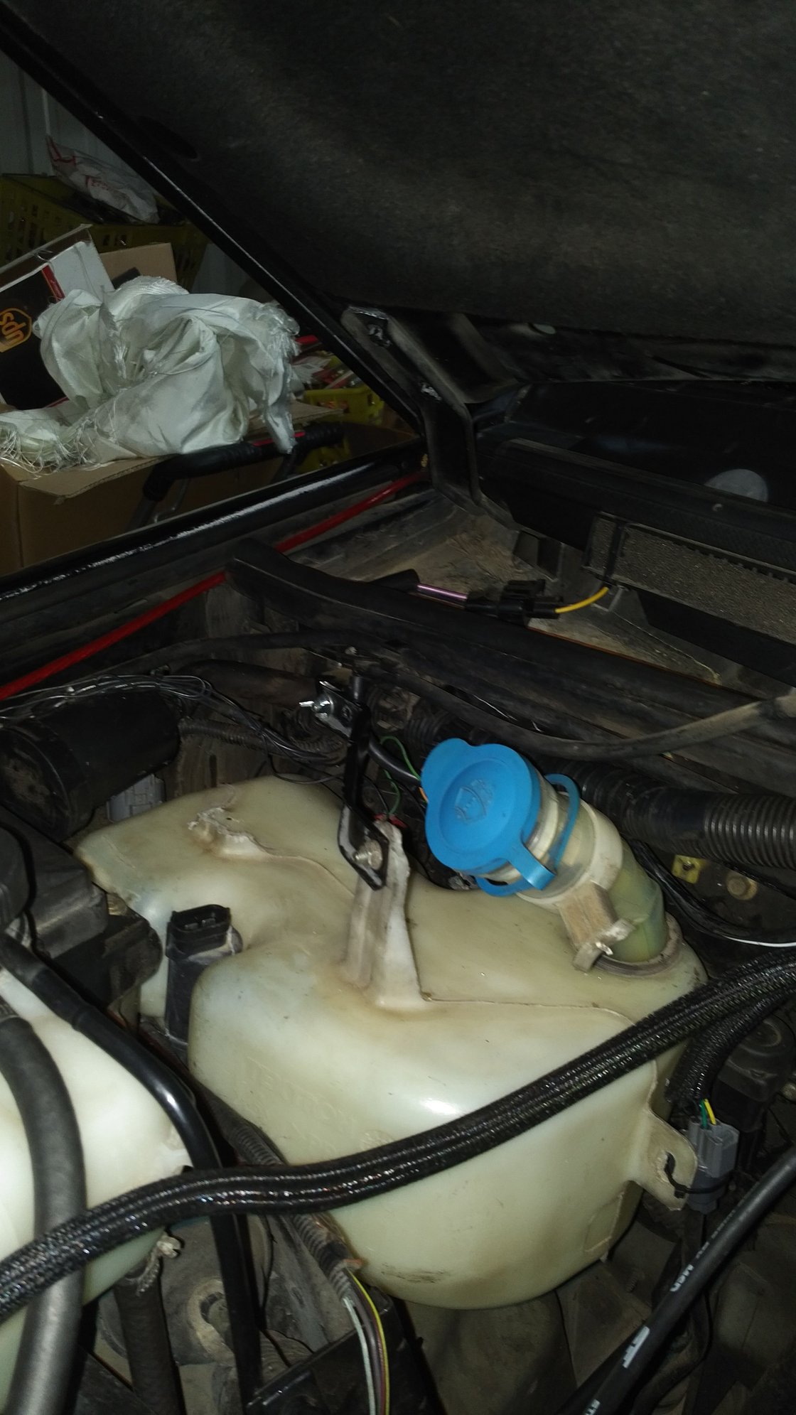

This has been done many times but as usual I added my own twist.... Which can be interpreted as I took the fast and ghetto way out. Turned out pretty sweet though.
I'm waiting to hook up the headlights sprayer pump and plumbing until I've got my front bumper built. But the rear sprayer and windshield sprayers work great.
The bracket i used to secure everything is the same one that secured the reservoir vertically in its stock location. Had to massage it some.
The tab on the side of the resevoir was perfect for securing my O2 harness
I simply cut, heated, and bent the factory filler tube to fit close to the firewall. Im going to opoxy the factory locating collar to the top of the reservoir to make the tube more secure.
