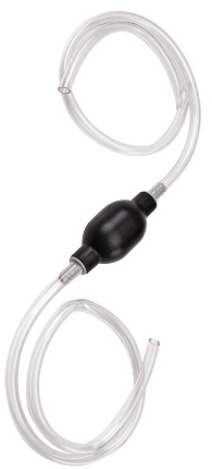

A very inexpensive ( all of about $5.00) Fluid Siphon Pump from Walmart, HF, Home Depot, or any Auto Parts Store works well too.
