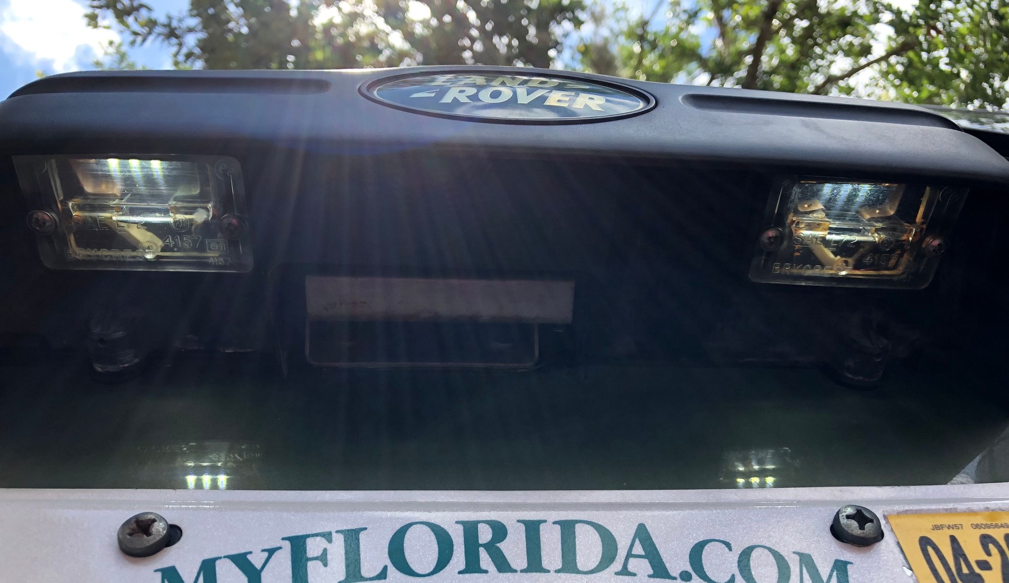

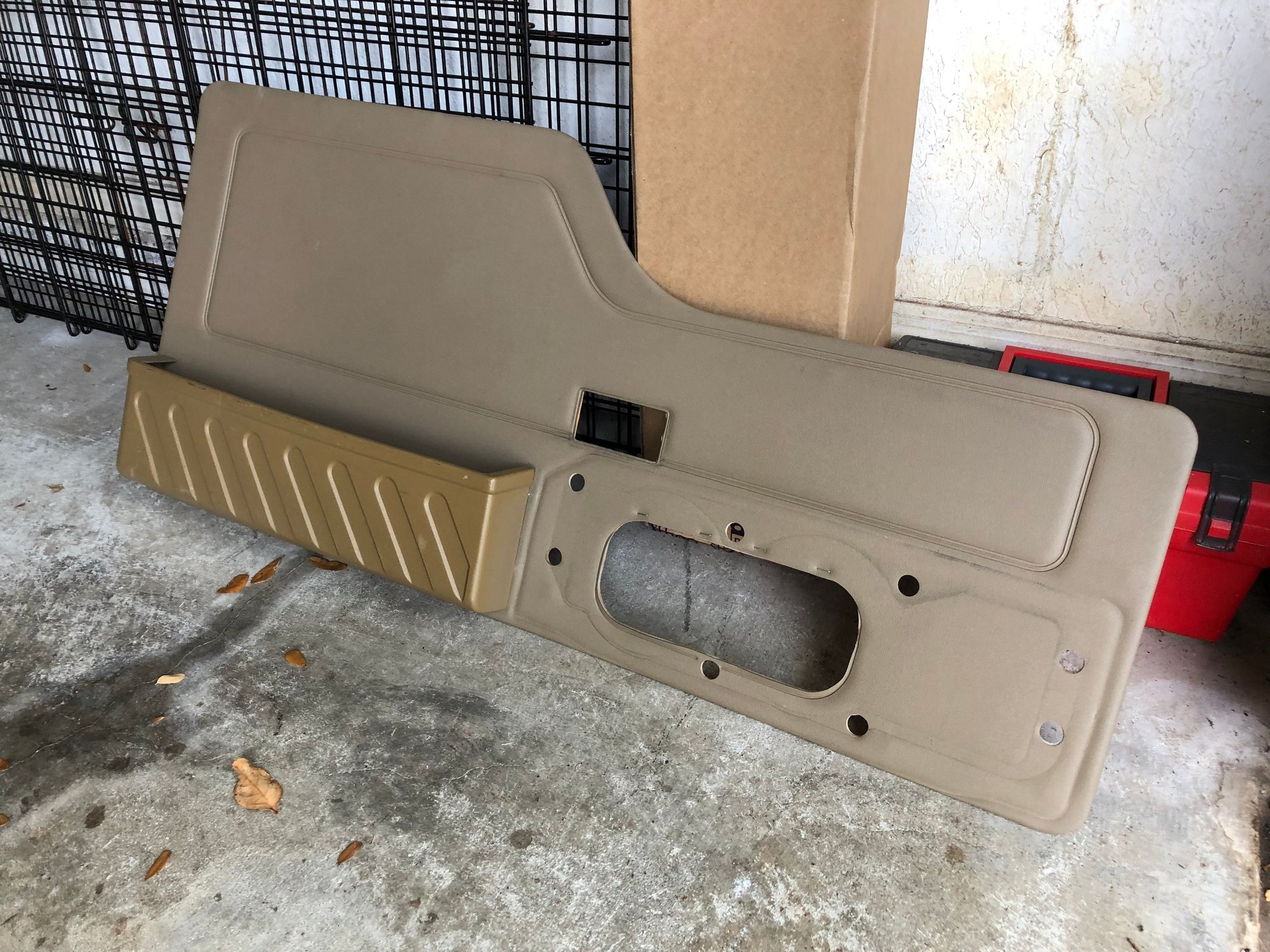

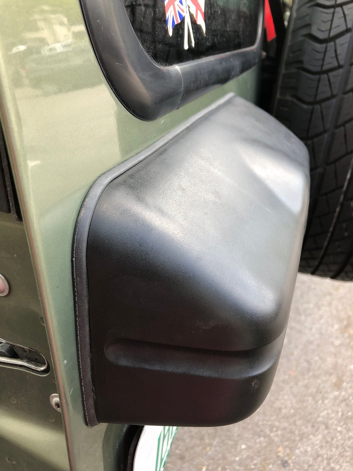

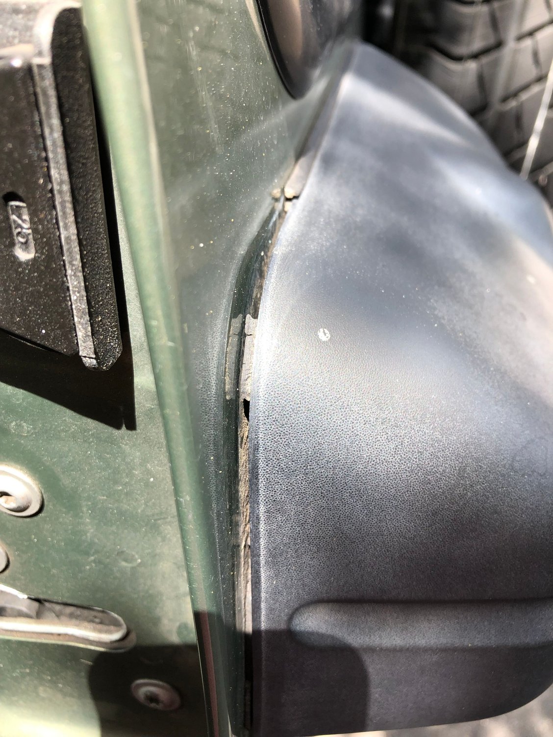

Hello there! I’ve had such good luck finding helpful info on this forum for my projects, I decided to join and contribute. My husband has a 2001 Disco II which I’ve adopted. What’s his is mine, right?? The license plate lights looked tired, dingy, and orange. Water was getting into the cover due to a rotted gasket around the back. I picked up a new one on the Rovers North website for about $45. To replace, remove the interior rear door panel. You’ll have to remove the speaker cover and speakers in order to remove the panel. Near the upper right corner of the plastic covering over the “guts” of the door, cut an opening which allows access to the nuts/bolts for the latch cover. You’ll see 4 nuts but you only need to remove the outer 2. Good luck with the one on the right. Land Rover tucked that little guy way up in the corner. Thank goodness for small hands. Remove the license plate light covers and bulbs, and gently pull the wires off the covers. Pop out the green Land Rover emblem from the latch cover with a flathead screwdriver or similar tool. If you look inside the cover and upward, you’ll see a bolt head. Remove that bolt. You can then take the latch cover off the door. From there, I took everything apart (removed rotted pieces of original gasket, pulled wires out of the cover, etc). I washed it and put Mothers back-to-black on it. I washed the rust dust off the license plate light covers and the rear door under where the cover had been. Once done with all the cleanup, gently feed the wires through the appropriate hole in the new gasket. Route the wires through the cover and push the new gasket onto the back of the cover. Replace the bolt behind the Land Rover emblem and the nuts inside the rear door area. Put the license plate bulbs and cover back in. Then put everything inside the rear door back together. (Side note: inexpensive LED bulbs were put in and they look fantastic!)

Dry rotted gasket
