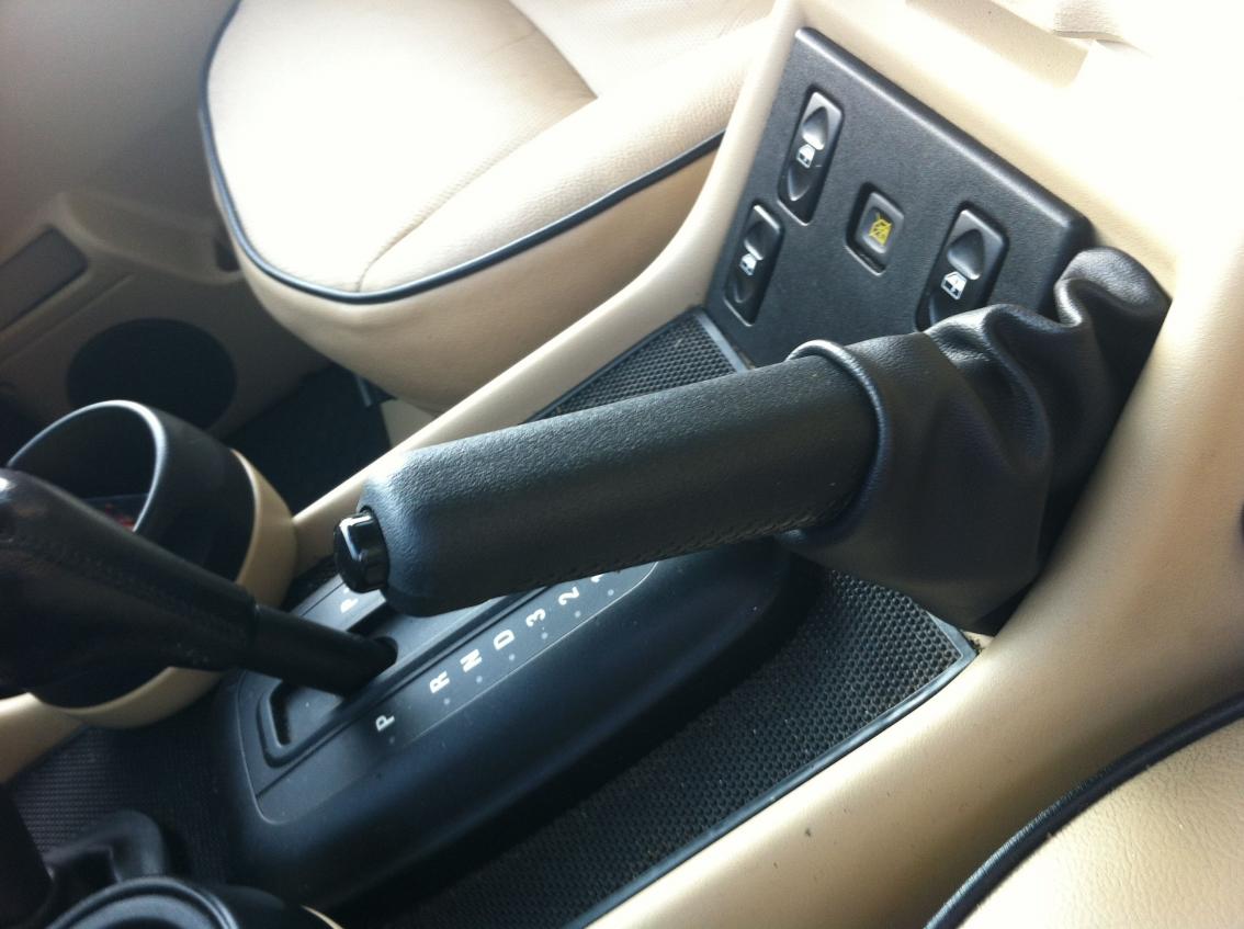

When I bought my Disco, it looked clean but the e-brake boot "leather" was all cracked and gross. Diff Lock shifter boot is in better shape, but on the way to being gross too.
User gschmitt sells vinyl replacement boots for e-brake and diff lock shifters for about $20 shipped (dealer wants $120).
I did my parking brake boot last night. Started with liquid super glue, which is difficult on fabric. Then realized that a hot glue gun would be perfect for the inside of the vinyl's fabric. I messed up one side, so I ripped it apart and reapplied (which can't happen with super glue). Also, hot glue will not crack with heat like super glue can.
Great product, likely to do the diff lock shifter tonight.
Attached Thumbnails Replaced leather e-brake boot-photo-mar-29-8-02-18-am.jpg

The boot attaches to the console with a wire frame. I didn't get a picture of it, but it is a rectangle with a rocker on it (think the rockers on the bottom of a rocking chair). As you pinch the two ends closer together, the rocker bends and allows the rectangle to be pulled out of the rectangular hole. Remove there first, and then you will end up turning the boot inside out to free the side closest to the handle. The handle isn't removed on the e-brake to replace the boot. Once inside out, you will see that there is a thick O ring that attaches around the boot, which fits in a groove around the handle, before turning right side out.
