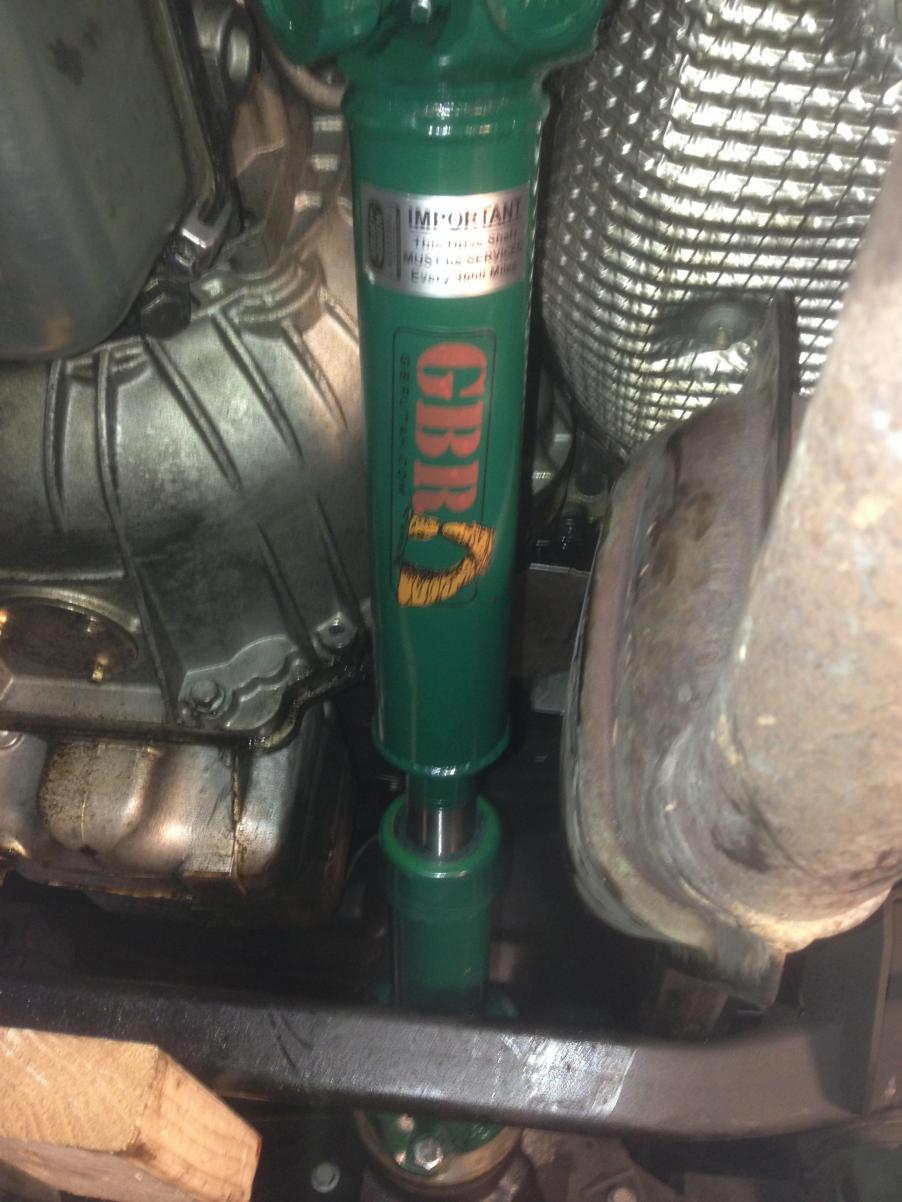

Ok, I did it removed the stock shaft and replaced it with a GBR HD shaft, took her for a spin and no vibration and a little more peace of mind. Went together pretty easy, 8 bolts and while I was under cleaned up all the oil splash, now I will be able to see where any drips are coming from. Thanks for all the help and advice, next new stat and get rid of the Dexcool I took a few pics but whats the trick to uploading them? do they have to be compressed before upload?
