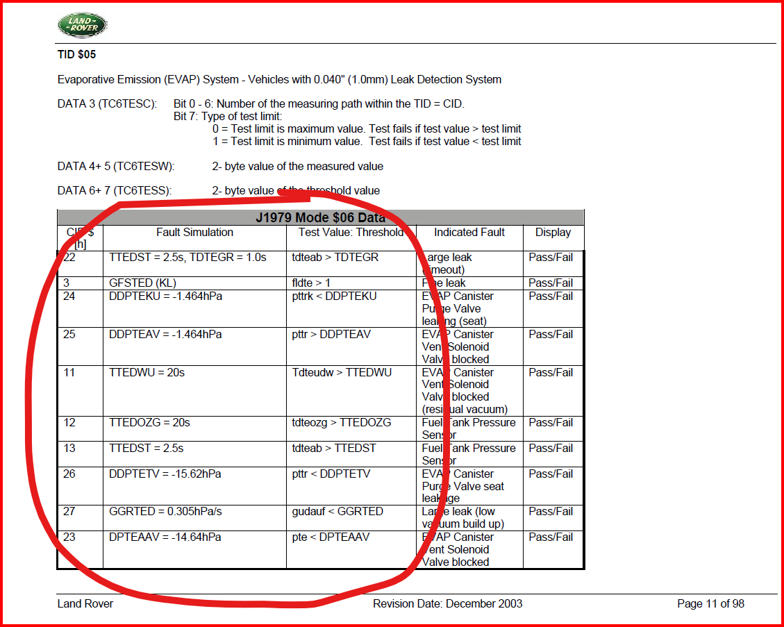

I am trying to research some error codes that popped up on my truck. have the attached copy of the Bosch Motronic manual. Unfortunately, I am not sure where I downloaded it.
My version has some jumbled text, example: please see the screen shot below. Does anyone have a better version of this manual to share? Thanks in advance!

I think that is the original text and it is not jumbled. The seemingly random words are actually parameter/variable names, and their meanings are explained on page 15.
Thank you for pointing out page-15.
I am new at this area of diagnostics. Still learning
