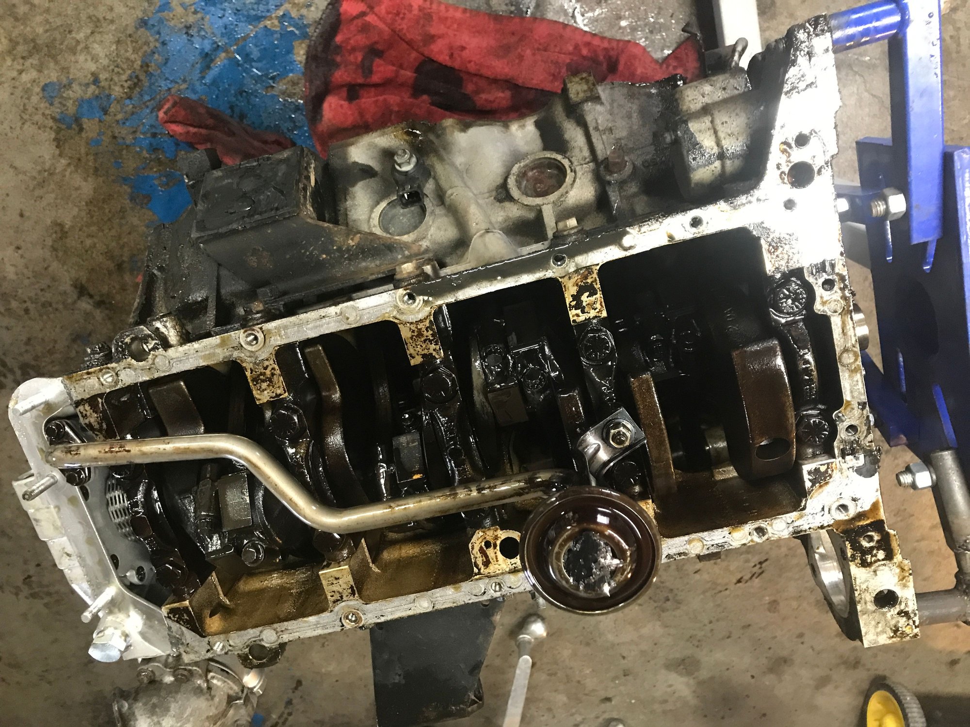

HI, thanks for response. I didn't see your post till now. Thats who I'm going to send it to. They seem to know alot about this motor. I got it all apart No. 1 rod bearing was completely gone from rod. Million pieces in oil pan. The rest were pretty worn and I think one rod is bent.

Anyone have any ideas on a container to put block, crank, rods/piston in? Should I build a small crate, plastic tote? Thanks guys!
