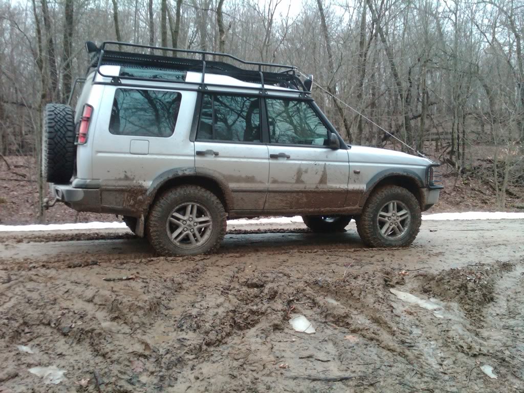

X2, 18"s will be just fine off roading. This is one of the best looking DII's I've ever seen.
What size 18's are those? 275/65 or 275/70. They look like Dura Tracs right?
Is this lifted at all? Looks like a 2" lift.

Old Aug 17, 2011 | 10:18 PM
DiscoRover007's Avatar
Joined: May 2009
Posts: 1,191
Likes: 28
From: Charlotte, NC
Those look like 275/65/18 imo. I run bfg all terrains and those look pretty close to that size. But I think Duratracs are a little bit bigger of a tire. Much more expensive though. I like the look of the 18's.
Actually those could even be 265/65/ duratracs.
