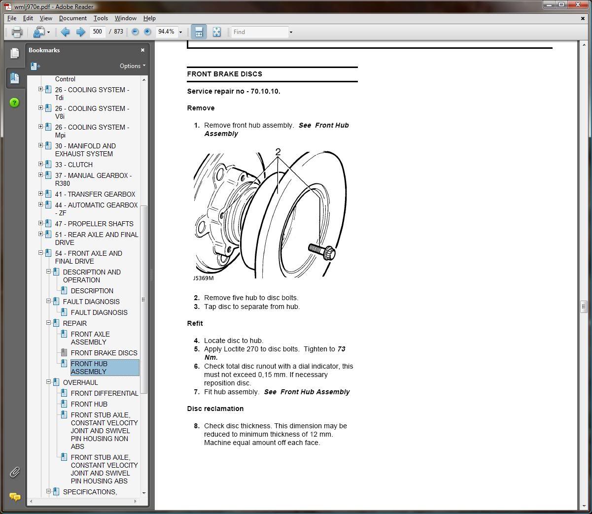

You have got to be kidding me with this.. you have to assemble the whole thing before you can check this.
I dont even have a dial guage to check it anyhow so I guess I could just hope for the best..
