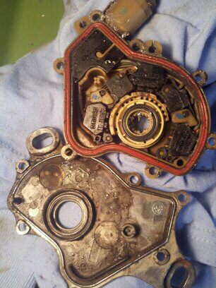

The type of codes logged may point to the location of areas needing some help with sealing against moisture. Spike and others are correct that some codes clear after a number of drive cycles. Some other codes will clear, then come back in two or four drive cycles. The tranny has a bunch of codes of its own, which report, make you drive in limp home mode, and in many cases turn on the M & S lights, but not always.
One place that is not on the engine that does not like to get wet is the XYZ switch on the side of the tranny, if gasket has a problem.
