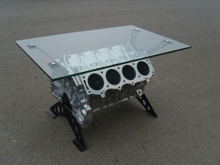

Or there is always this handsome man cave upgrade....
Old Aug 7, 2013 | 11:59 AM
drowssap's Avatar
Posts: 9,298
Likes: 318
From: Boston Strong
that's probably the best upgrade you can make to a rover motor
