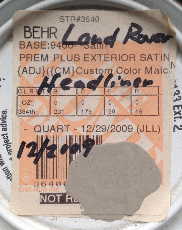

I hate it when threads get hijacked but since it was the OP who brought up the new topic here I go.
In my opinion painting the headliner is the only way to go. Use denatured alcohol to clean the off the foam and adhesive residue. Go over it one more time to be thorough, then let it dry and roll on a decent primer (I used Kilz). After that put on two coats of a good exterior latex house paint and it'll be great.
I did this nearly six years ago and I have been very, very happy with it. The best news is that it will never sag again. Some say "Why paint when installing new fabric is so easy?" The answer is that painting is a better solution.
My writeup on Dweb is linked below and the label from the paint can for my Bahama Beige match is shown.
D2 Headliner - Lessons Learned
