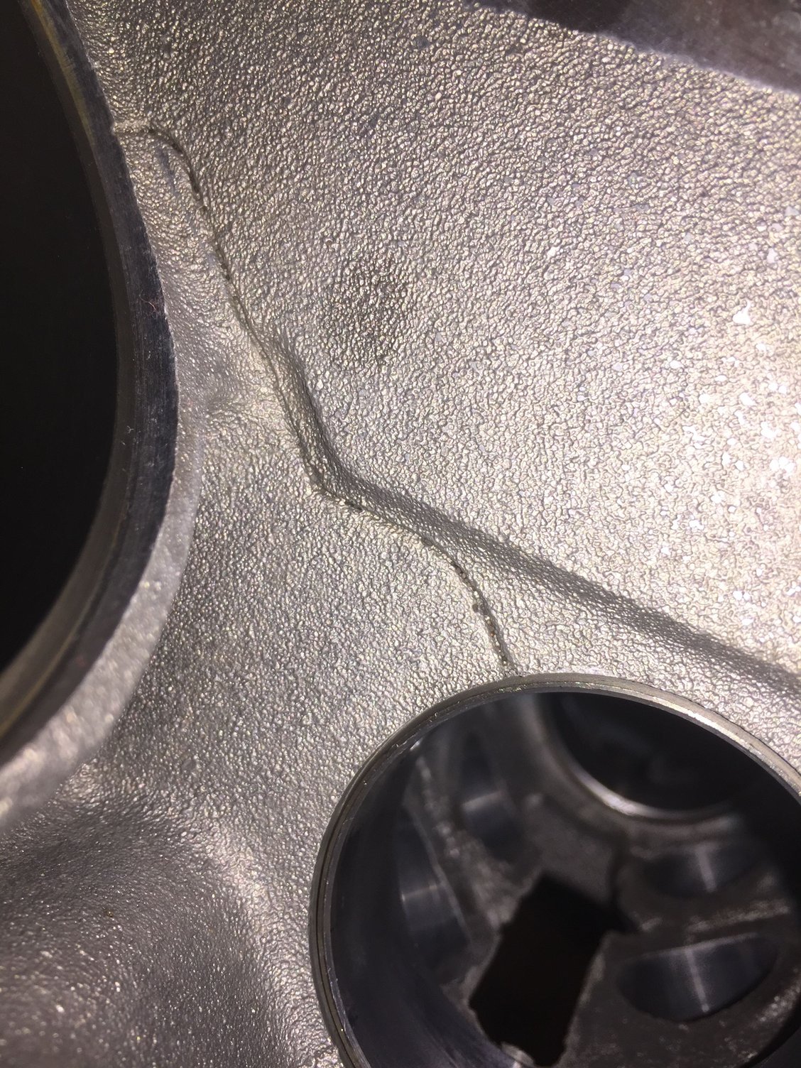

Spoke a little soon. I have "cracks" (or crevices?) on 3 out of 5 of cam bores. This one here (#4) extends all the way to the cylinder bore! I'm hoping it's normal, and that the machine shop did not royally mess things up reinstalling the sleeves or cam bearings.
That does look more like a mold crevice created during the block mfg than a crack to me. No affiliation with your machine shop and not any kind of expert on the subject.

You're probably right. Richard turner will know.

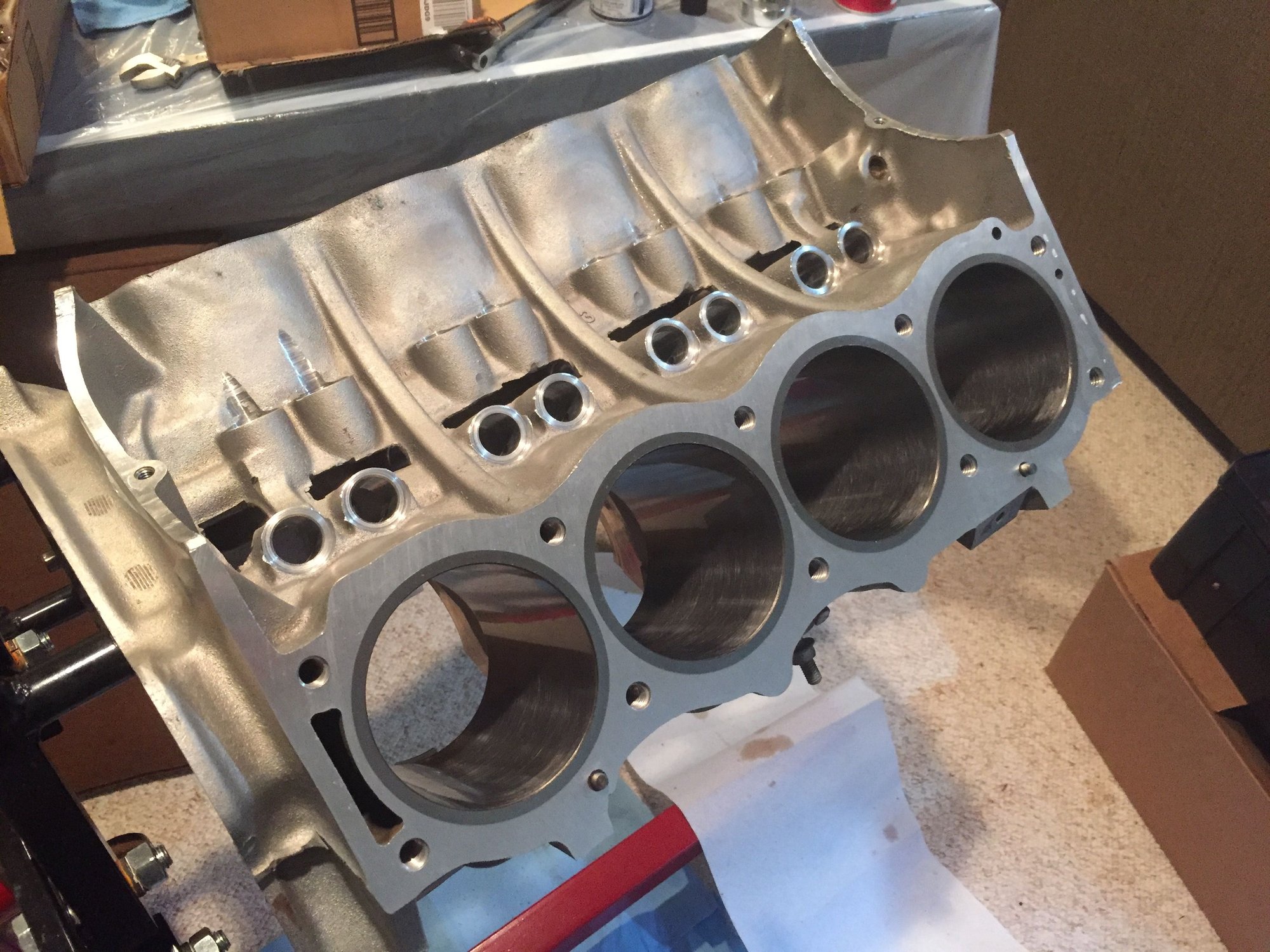

I think I'll wrap up this thread now - whew - and leave you all with one more photo.
I plan to start a new rebuild thread (for real this time) and document myself along the way with videos
Looks like a casting mark to me, too. Blew the picture up as much as possible and you can seem to see material between upper and lower area. Is there evidence of this "crack" on the other side of the casting?
