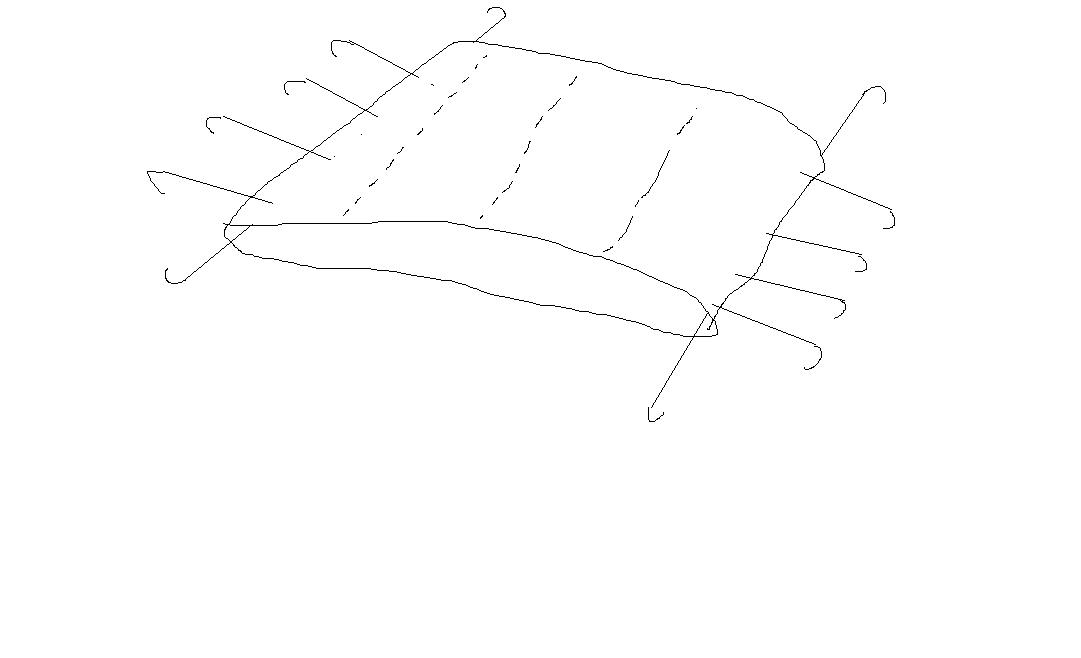

So...I just turned over 150k in my 96 D1...and the mesh under the drivers side seat blew out. Any ideas on how to repair this? Not to comfy to ride.

You could just replace both seats: http://www.roverlandparts.com/discov...ont-seats.aspx

goto a junk yard and buy a seat... take the foam off and install your foam on the new seat frame...

i fixed mine by taking a peice of upholstry viynl and sewing it into a loop and sliding all the original metal peices in it, I hope this completely illegable paint shop diagram will help explain what I'm getting at
