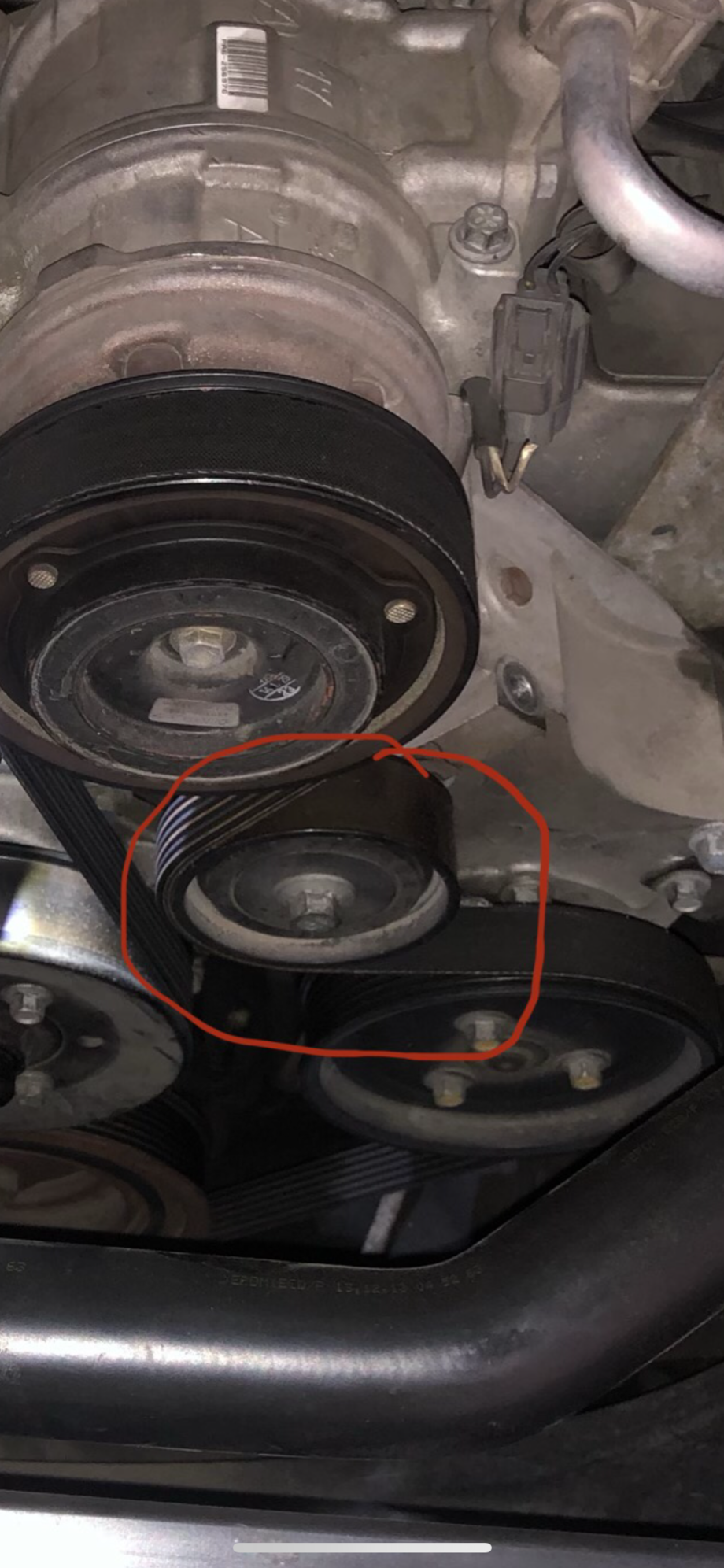

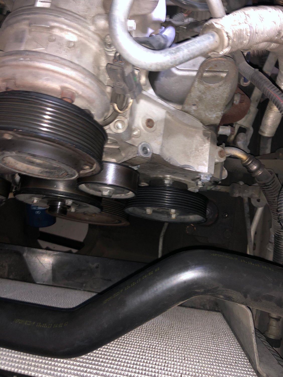

The bolt on the left is where I’m assuming it’s rubbing. The pulley circled is the only one I see that looks off set is that normal?

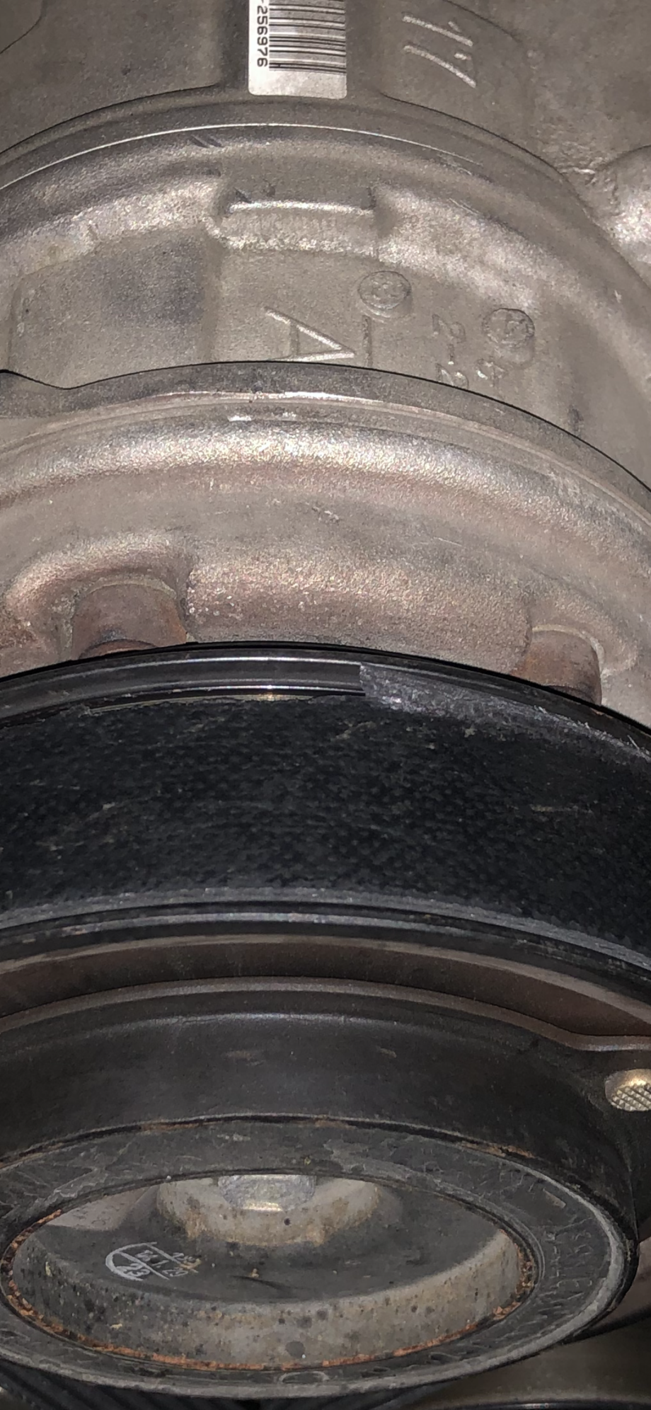

Does the pulley on top of the PSP look okay?

the belt should not be running off-centre on any pulley. the centre of every pulley needs to be on the same plane.
