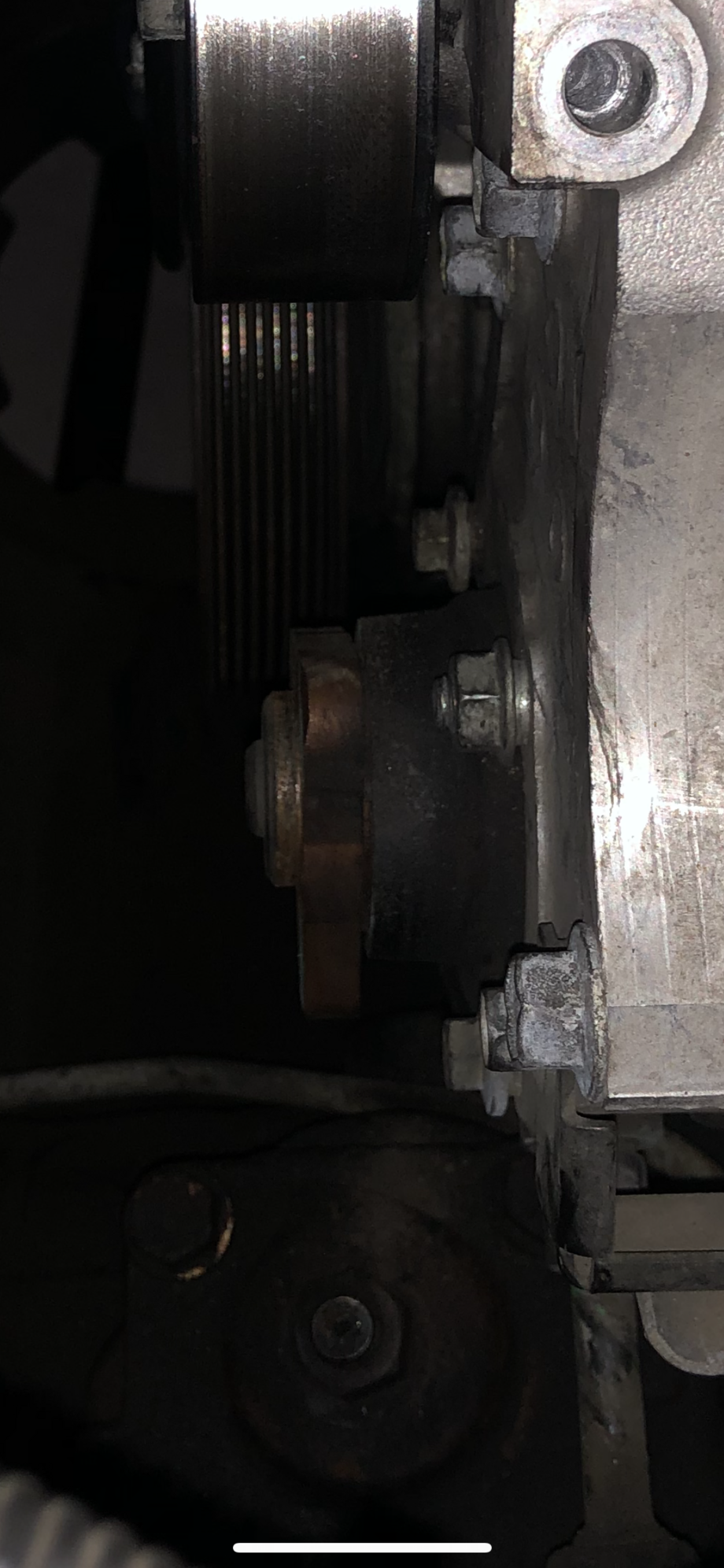

Looking at your picture...
The ps pulley and the wp pulley look aligned.
The idler over the ps pulley is not BUT NEITHER IS THE AC.
What I would do...
Remove the belt. Tap the wp and ps pump pulleys in the center and see if they move back in. I had a ps pulley come a few inches forward once because I had the belt on wrong. I have never noticed the wp do this and I dont know how it could.
As per your pics, there is something wrong.
Take a straight edge and lay it along the side of your pulleys. Take a picture.
What I would do...
Okay I’ll do that ASAP

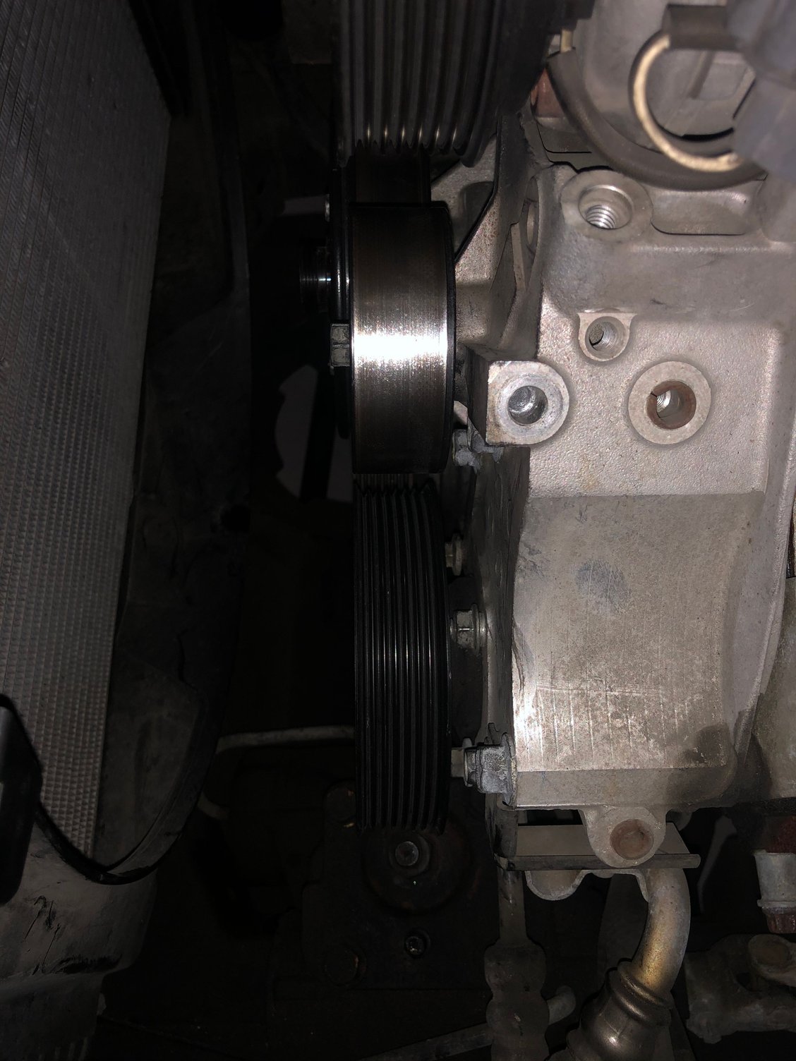

Open (popped out)
Closed (simply pushed in by hand)
Back in alignment
okay so I figured out why it’s out of alignment. My power steering pulley was pushed out making it off alignment.
i can literally move it in and out by hand with ease.
does any one know why this would happen and I’m assuming I will need to replace it correct?

Originally Posted by Carlos Man
Open (popped out)
Back in alignment
If it's not leaking or making noise, run it.
Mine did that too, I pushed it back in, aligned my serp and it's been that way since. If it starts leaking out the front replace it.
In your pic, it looked like the wp was also out of whack, is it or not?
