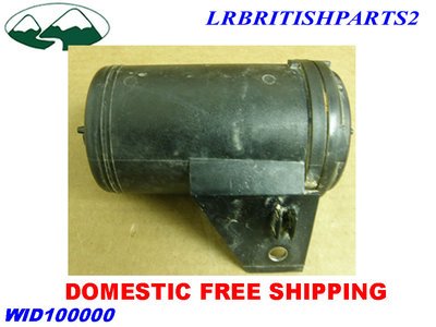

Recently poped a single check engine code: P1412. Diagnosed the problem with a fellow member over the phone and we concluded that the secondary air intake reservoir vacuum canister is bad. Part looks like this:

as a temporary measure I disconnected the thin tubing from both ends of the canister and connected them directly together thus bypassing the canister completely. I have every intention of replacing the canister - eventually. Used my "connections" at JiffyLube to clear the code. Now about a week later the service engine light popped on again, this time with 3 new codes: P1590, P1171 and P1174. Did a brief lookup in the Autozone computer and found several references to Oxygen Sensors (there is no Land Rover code thing in their system). With that in mind the previous owner told me that the truck needed O2 sensors.

I'm not very competent in diagnostics so threalassmikeg guided me through the process over the phone and he would be better suited to explain how we determined that the canister is bad. We checked various hoses, made sure their was suction, tried disconnecting and reconnecting connectors etc. So without more detailed info in the matter should I first purchase a replacement canister BEFORE going out and buying new O2 sensors? RoversNorth is the only place that sells them new but they have to special order them directly from Britain. Price is only $100 shipped so I can do that in afew weeks.

You might be able to get a canister from a salvage yard or a dismantler like Paul Grant. If yours has a crack perhaps some JB Weld would help you out.

The vac reserve container is there so that when the system calls for it by computer, vac is available even if you have it floored going up hill and have low vacuum. There is most likely a check valve associated with the canister so that the vac reserve is not drawn off by other vacuum users upstream.
Well if I can avoid having to purchase another battery then I will buy a brand new canister from RoversNorth next week and see what happens. Maybe my canister is clogged or something. If this part is as important as implied here then Id rather just spend $100 and buy it new.
