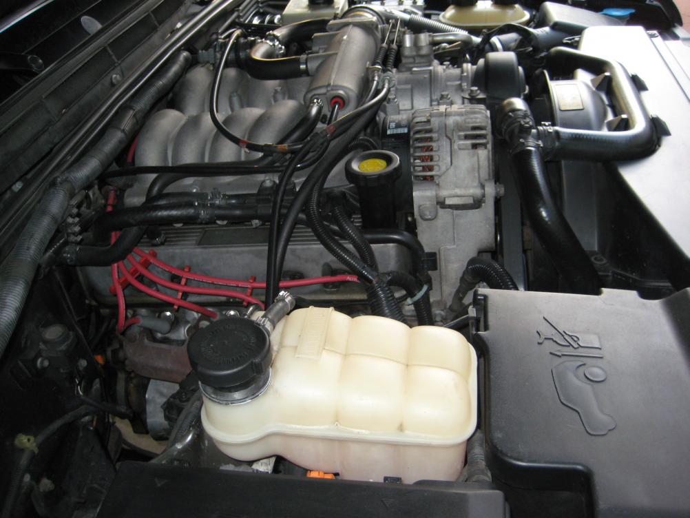

There are many post here about wires...
make sure you find some good 8mm wires.
( I found some 8.5 mm when I was in Vancouver last year)
