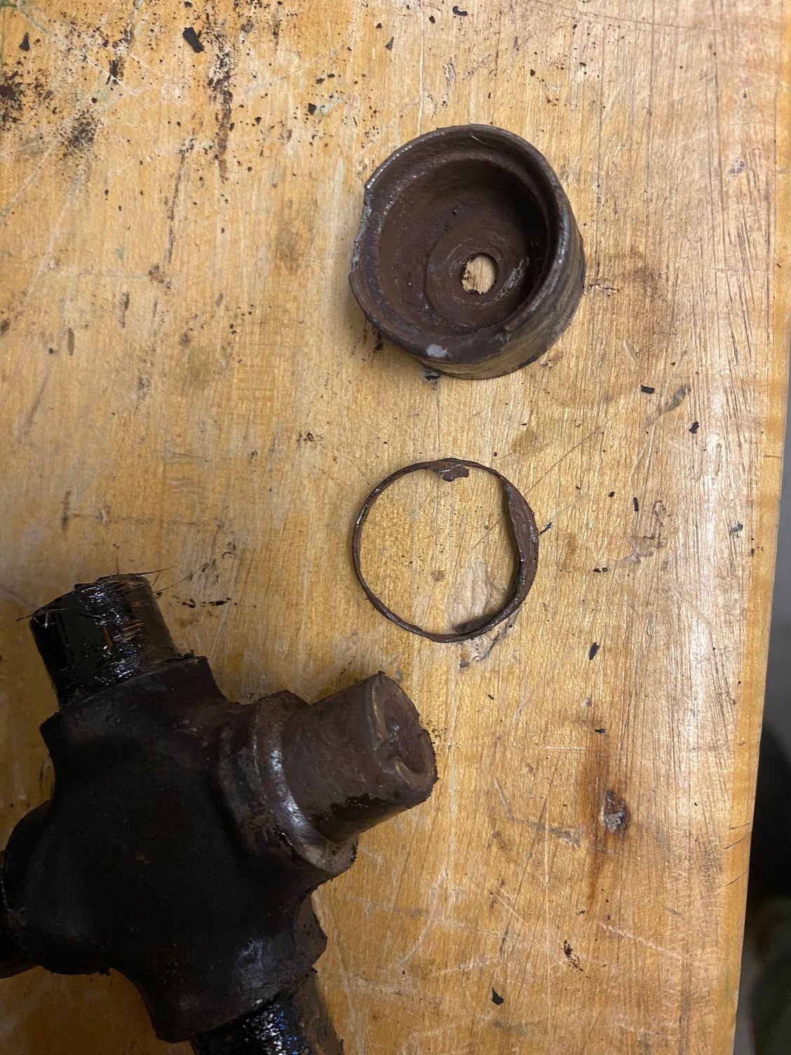

Upon closer inspection of the front drive shaft I found one of the bearings on a U-joint in really bad shape. It's the front one in the double cardan joint, I'm glad I caught it when I did. Now I'm just thinking about what to do with it- do I take it to a shop and only get the one replaced? The other ones look good and the shaft is easy enough to take out (I bought the thin wall impact extension, highly recommended).

So I decided I’m going to have a go at doing this myself, this is, after all one of the reasons I have the D2. I watched the u joint video from the “Chris Fix” YouTube channel and it looked pretty straightforward, even more so since I have access to a 12 ton press at work. I was able to remove the questionable u joint and found that the bearing was completely dry, rusted and not a needle bearing to be found (see attached pic). What’s odd about this is that this is the bearing that had the zerk fitting for greasing. All the other bearings look fine. Anyway, my replacement joint just arrived at NAPA so here’s hoping it goes in just as easily as it came out.
