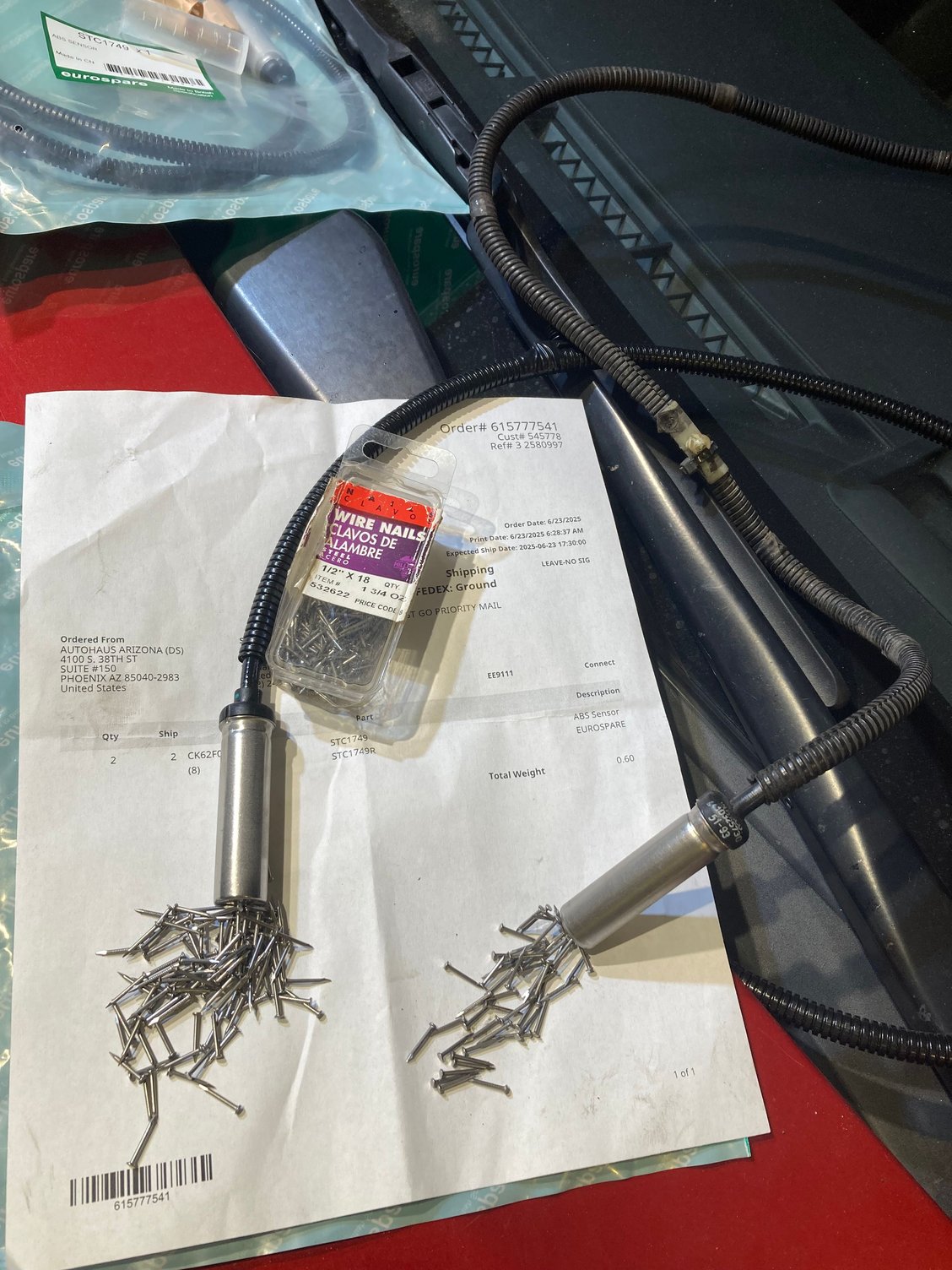

I want to share this with my D2 friends. Replacing the front ABS sensors has so far solved the annoying even dangerous problem of ABS activation at slow speed while turning. The new sensors have significantly stronger magnets, as demonstrated in the attached photo. These were on sale for my D1, less than $65 for the pair, delivered. Price finally was low enough for me to experiment. First test drive passed with flying colors. Will follow up if that changes. Hope this is helpful. Rare earth minerals rock!
New ABS sensor has stronger magnet

Kinda strange, these don't look at all similar to the replacement sensors I bought. The ones in the photo look 2-3x longer.
Are these for the rear or something?

Sorry for the confusing information. The photo shows D1 sensors. Just sharing the information due to similar failure mode (weak magnetism) for old D2 sensors. The D2 sensors form is indeed quite different. Hopefully still useful information.
