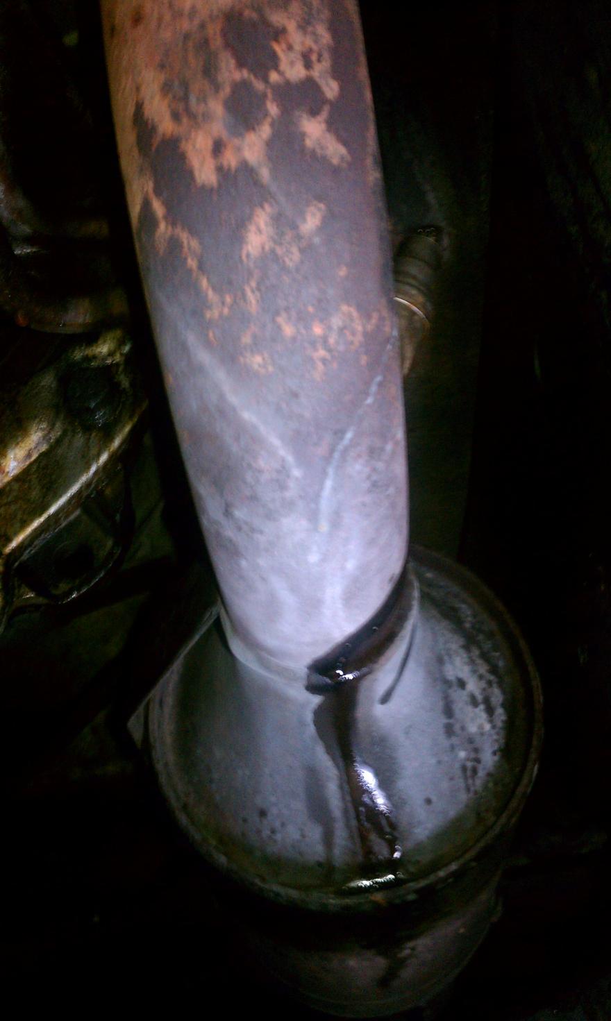

When I went to check the t-stat, I dropped my pliers, and found a bit of oil leaking when I was under the truck (pics attached).

3. Head Gasket work: There are signs of oil leaking from it, and my mechanic said this could be a future problem back in June.

Heat is not stable as you have air in the system and low coolant, or both. Steam won't make as much heat in the core as hot water. If those bubbles under the dash are exhaust gas you could have head gasket leak or cracked block. An exhaust gas in coolant chemical test will confirm what the source of the bubbles is. A coolant pressure test will show where leaks may be.
Radiator could be partially clogged. The cooling tubes run left/right, and sludge makes bottom ones block off. Use an IR themometer point and shoot to measure the temp just after shut down, top to bottom on the fins, looking for 10F difference or less. Mark I palm reader not reliable for this.
Temps dropping on highway (or much higher in town) might also point at the fan clutch, blades for fan, or electric fan.

Is replacing the head gaskets something that I can do myself, and just have the heads planed at the shop.
Taking my time this weekend, and going step by step using the RAVE is well worth saving $1k+.
Until now, I've only been a brakes, oil, and transmission fluid changer.
Let me know what I'm in for, and if I should just bite the bullet and take it to the shop for full repair.

Plenty of real Rover rascals on here have done that and posted the steps, etc. About two weekends under the hood, with machine shop inbetween. $300 ish parts (use new bolts), plus machine shop inbetween. Shop will want the parts, plus machine shop, plus mark up, plus haz mat fee, plus about 12 - 15 hours time.
