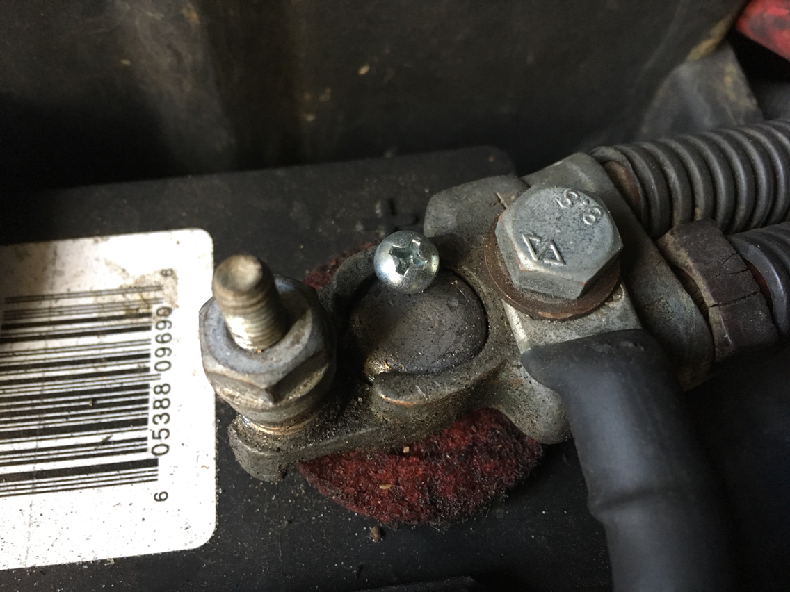

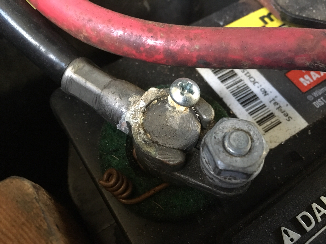

Companies sell shims for battery terminals, or you can cut the cables and install new terminals, but I took a more ghetto/redneck approach and drilled small holes into the joint between the battery post and the terminal, then simply screwed small screws into those holes and the terminals are now holding very tightly.
Redneck? Yes. Ghetto? Yes. Effective? Yes. Simple? Yes. Inexpensive? Yes. Time consuming? No.
Look, it may not be elegant, but I grew up a farm boy and learned to do what you need to do without taking off a day or two to get the repair done.

@mln01, damn that is ghetto
