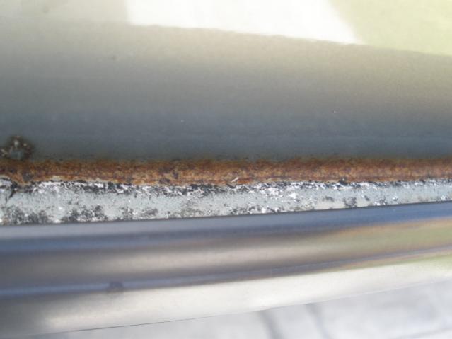

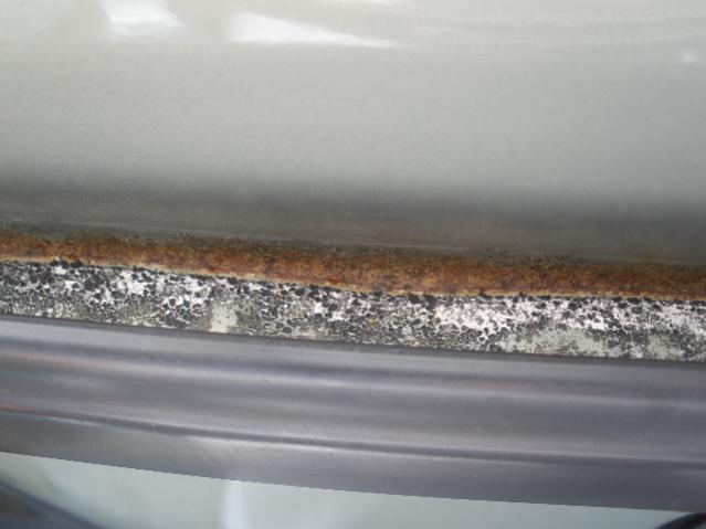

Side Rails look corroded, Should I seal them and with what?

the gutters. mine had paint missing and rust showing. I now have fingered a thin clean bead of rtv in there. I scrubbed the bad spots with a wire brush, taped it off and sprayed that rustoleum rust reformer in there, first.
I am sure that there is a better coating, other than that rusto stuff. I just had some on the shelf
edit= I just recently tried out that clear infomercial leak stop junk, on a residential gutter. it had holes through it....it no longer leaks.................just a thought.
