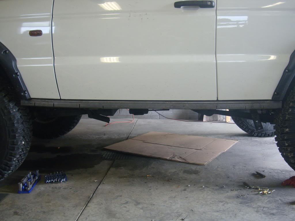

Will do as soon as the coating is fully cured. They fit just like the first set I made really. Nice and tight to the body with the proper contour.
Taken right before I welded up the slider tubing and added the step.

Is it possible to make them an inch or so shorter? Looks like they could rub on articulation. Have you tested that yet?

The ends weren't finished and capped yet... you don't do that until the tubing is welded completely because the steel will shrink up a little and I wanted them to finish right at the end of the flares. so no issues there Zak. They fit properly, length wise not to short or to long.
If you look closely at the picture above you'll see there's no angle to the ends signifying no caps yet
