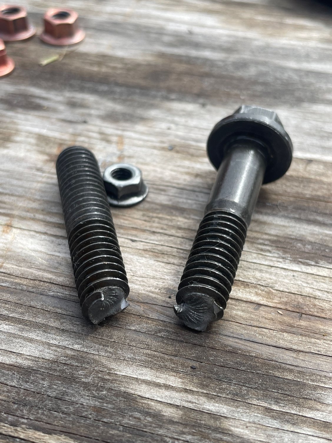

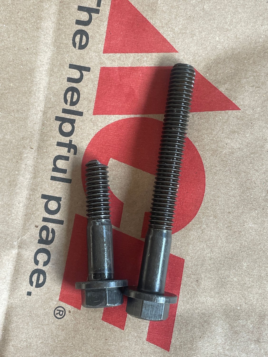

Installing new head bolts. Torquing to 15 ft.... Set all bolts in counterclockwise, gradual tightening. Used a 4-5" extension on torque wrench. Could *NOT get torque wrench to click..... kept tightening down... No clicking on any of the 10 bolts... kept tightening, and then the middle bolt f-cking snapped off...
I bought the bolts from Rimmer Bros... The original ones they sent me showed up with rust (not a great initial impression) and to their credit they did replace them... did I buy junk or is this something I did wrong?
ERR2944 is the part
CYLINDER
HEADBOLT 7/16 UNC X 3.78 GENUINE
bolts that the company replaced:

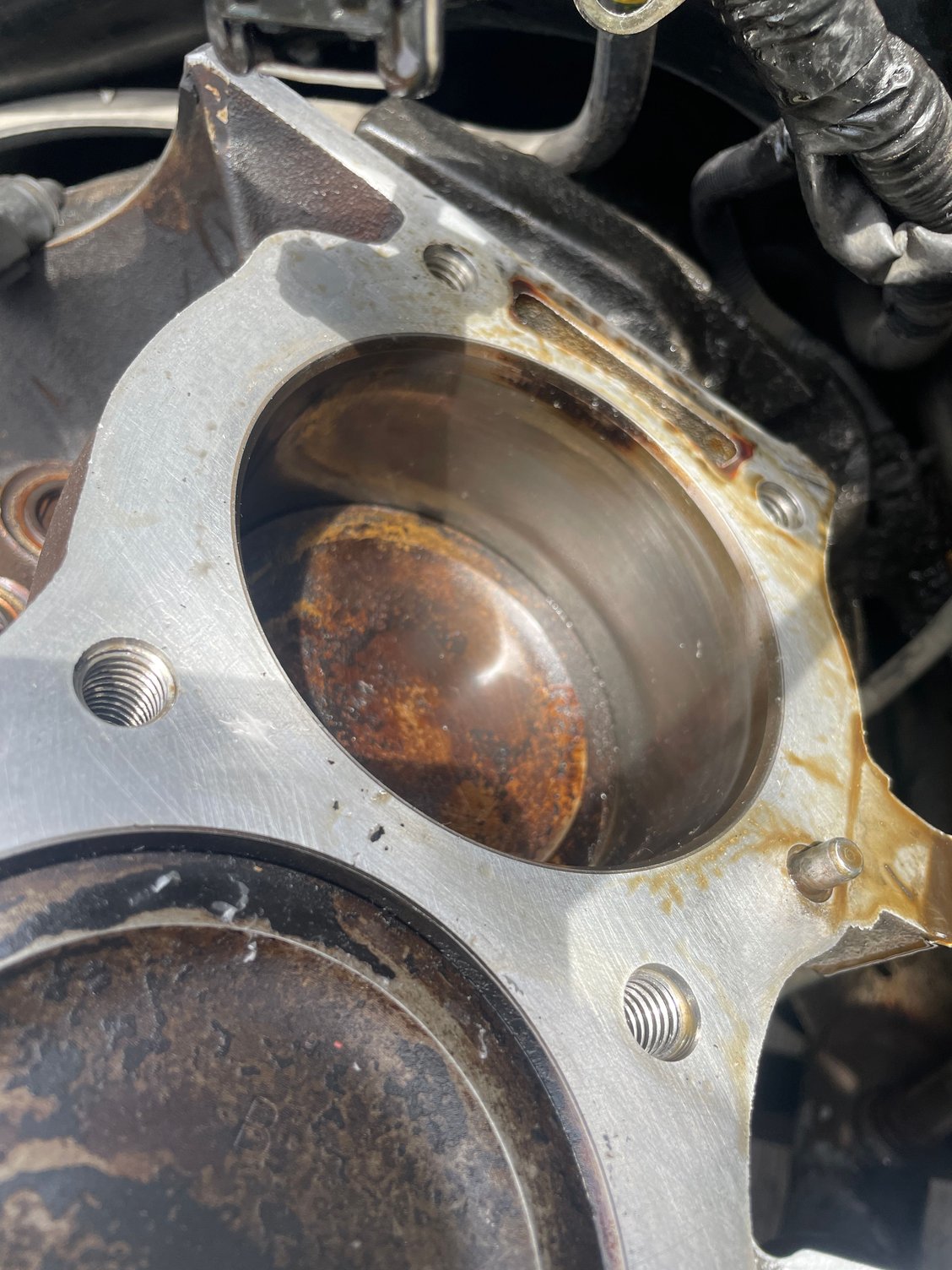

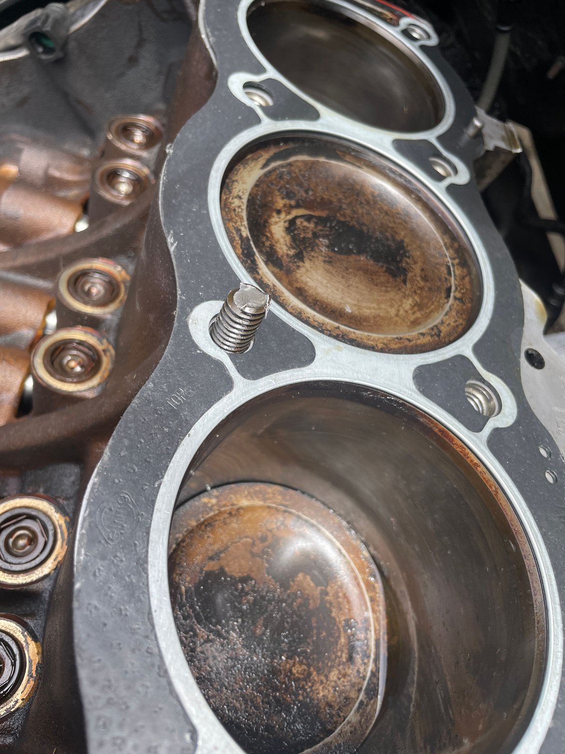

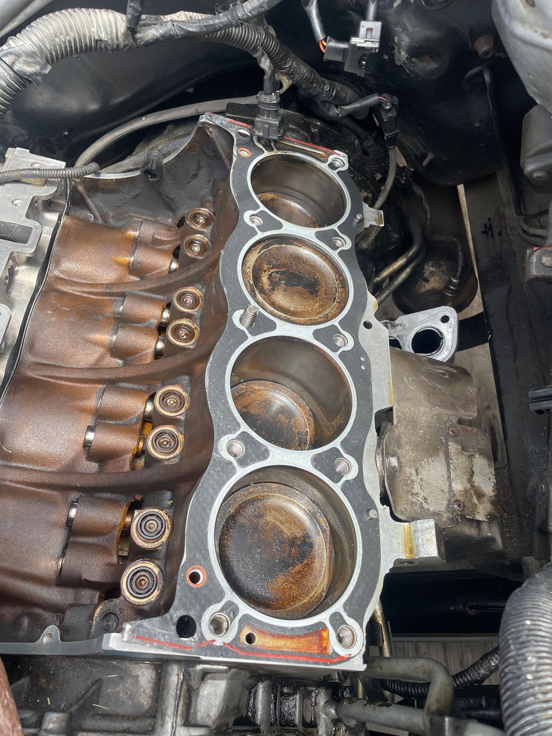

Thanks as always... Helpful info... Definitely something funky with my torque wrench.... Won't be using it again.... I took the head off, and the bolt half that snapped was in there pretty loosly....I hand twisted out - is that normal? Not sure what to make of it. Could I have bottomed it out? Do I need to replace this gasket?

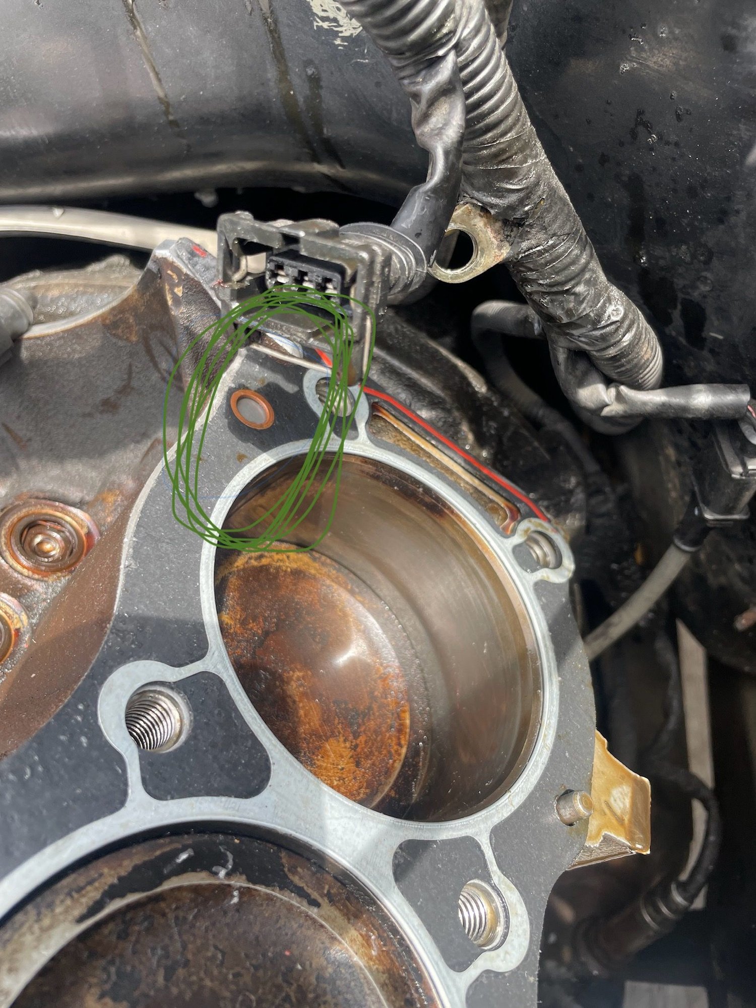

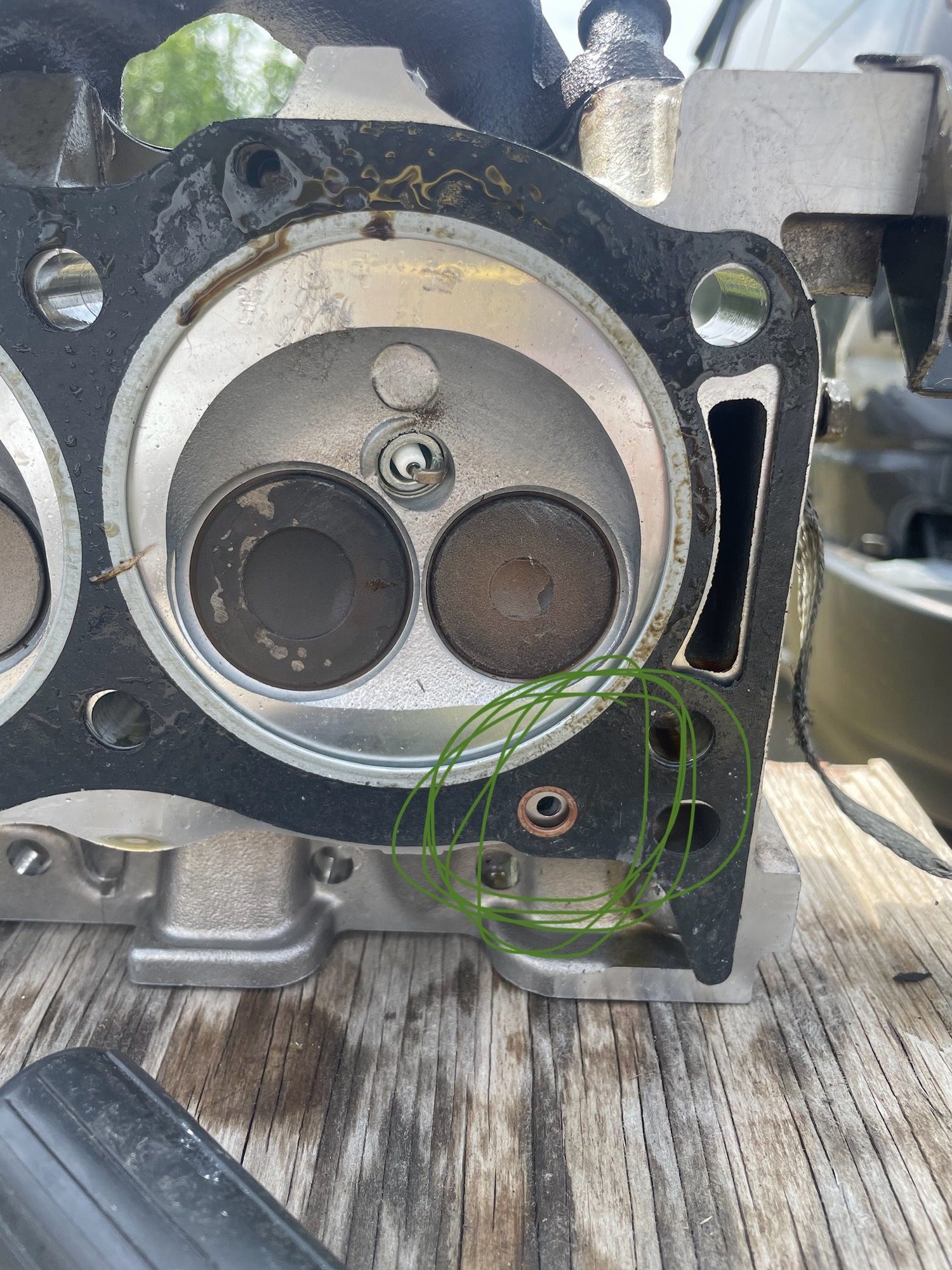

Blew air into all the holes before I installed the bolts multiple times.... Repeated after taking head back off.... The rear upper bolt hole was weeping dark oil (didn't do this when I installed)... I don't think it was from the dip that I did right before first attempt at install (bolt to the right of the copper circle in pic below- driver's side top rear bolt). However, I'm hella confused why the rear oil delivery holes on the heads don't have a mate on the block (circled in green)... Can someone please explain this to me... Confused.
This is the oil delivery hole that I don't see a mate to on the block.... Confused
