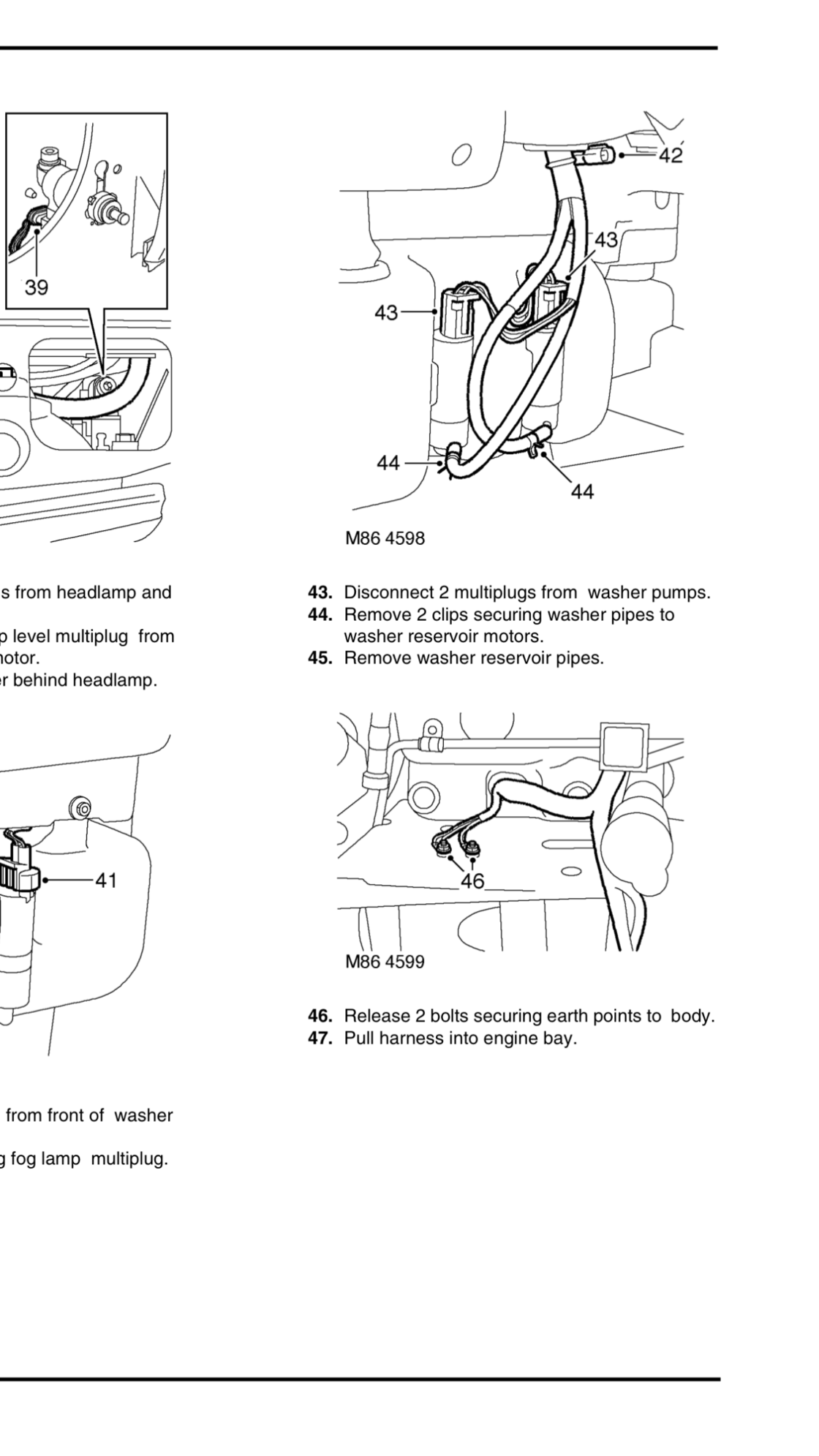

First off check fuse 29 in the interior below the steering wheel and try to swap a relay with the ace relay to see if the relay could possibly be bad. Attached are a few photos from rave that might help. I wish you could give some codes. Also when it blows the fuse, does the vehicle still operate fine or is it swaying or leaning toward one side or anything.
