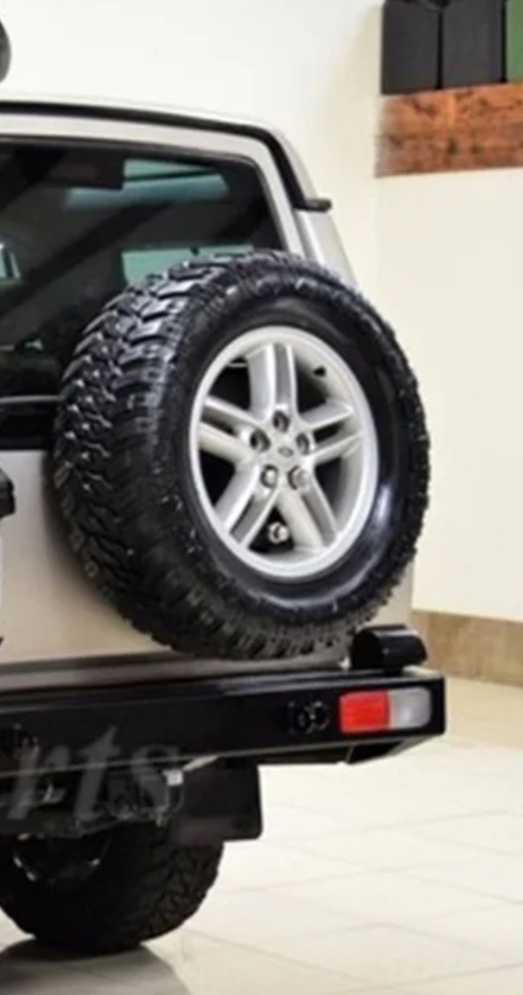

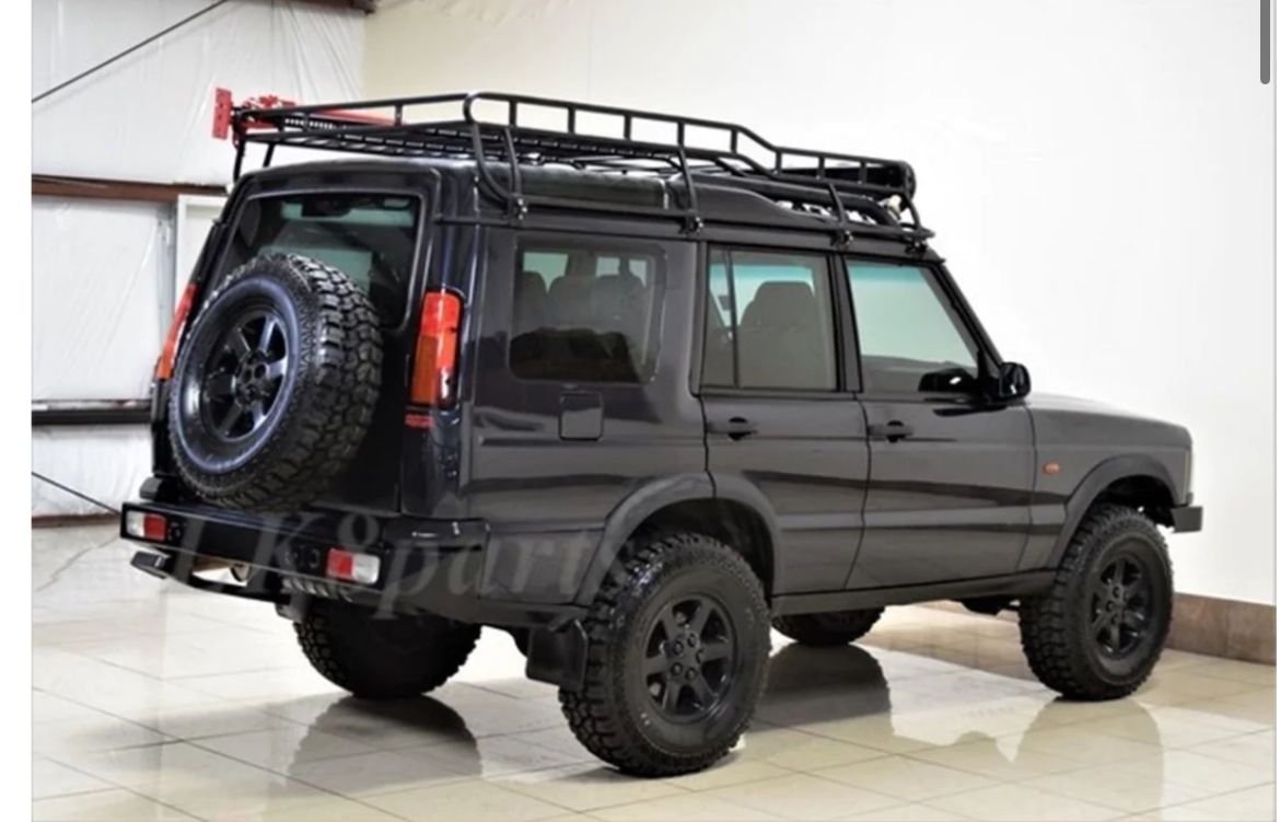

I purchased a steel bumper from the boys at L8. And noticed what appears to be an offset spare tire carrier on the D2 in their stock photo.
Is anyone familiar with this setup? I want one.
