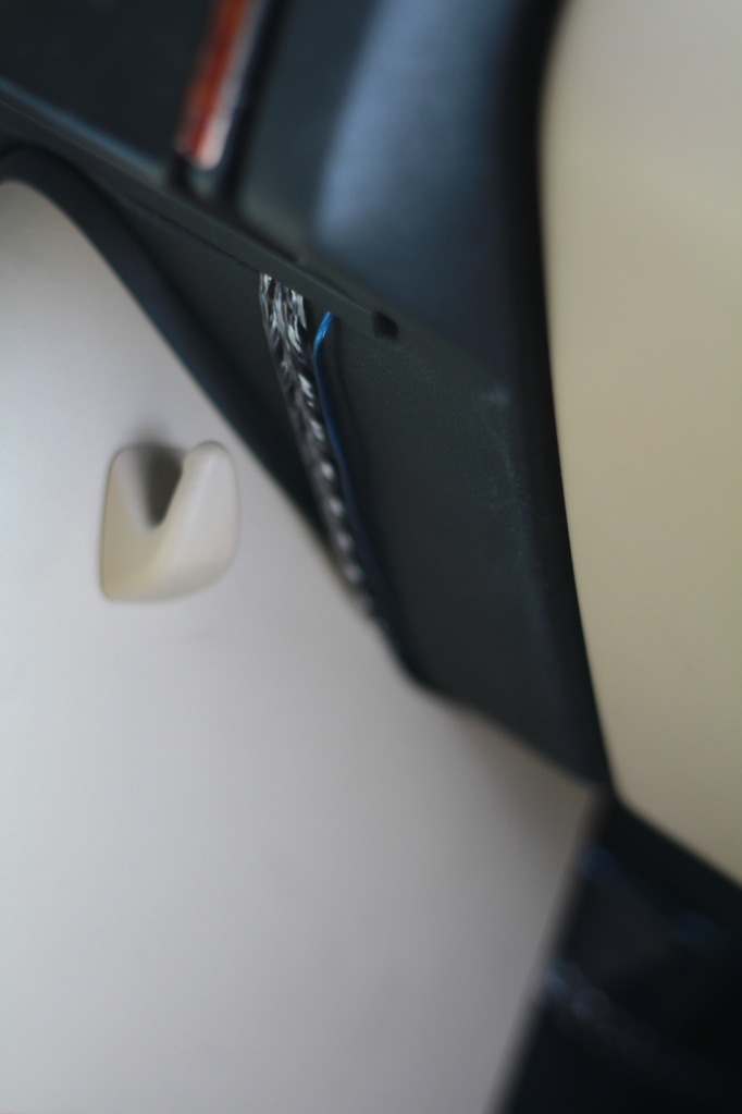

like MChang said. Buy a wiring hardness designed for your Disco. In my case (a 2003 with the factory Harmon Kardon) Connect all the color corresponding wires to the back of the new head unit you purchase (it will have two blue wires if it's designed for the Harmon Kardon unit one remote power for the factory amp, and one remote power for your aftermarket subwoofer amp). You will also need to purchase an amplifier install kit which will consist of a power cable from your battery to the amp, a ground cable, a remote amp cutoff cable(blue small gauge wire)RCA cables(for your audio signal) and associated connectors

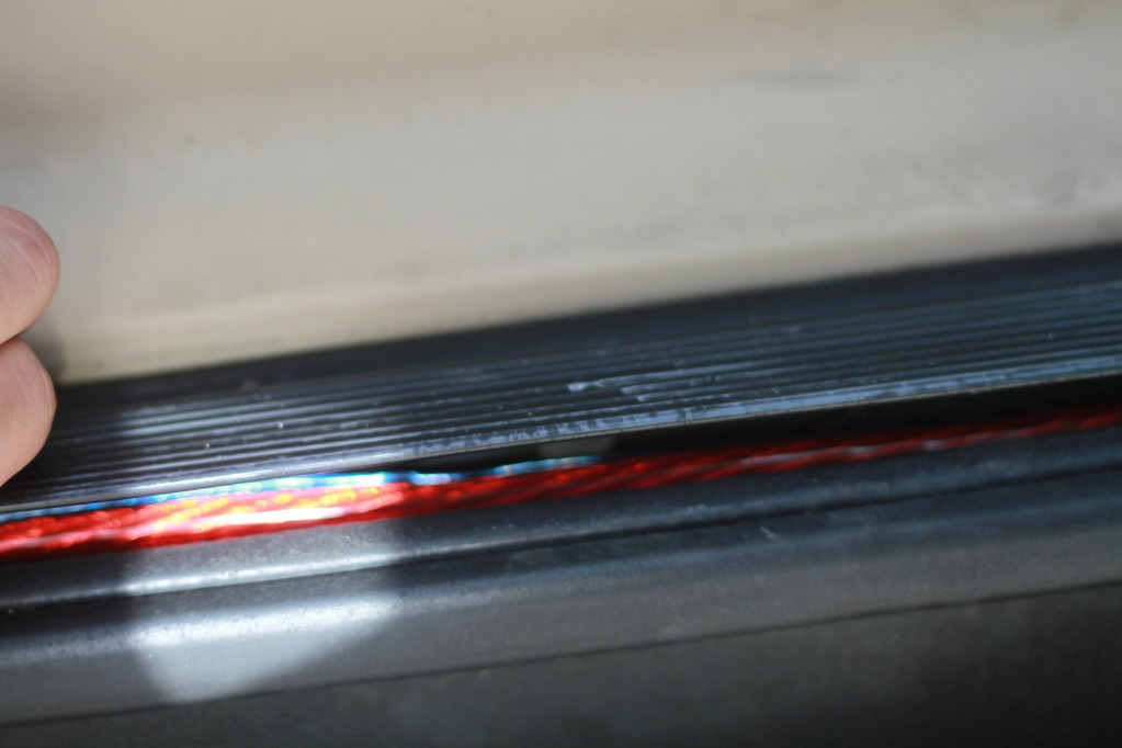

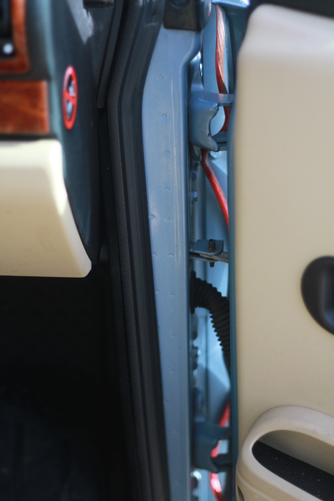

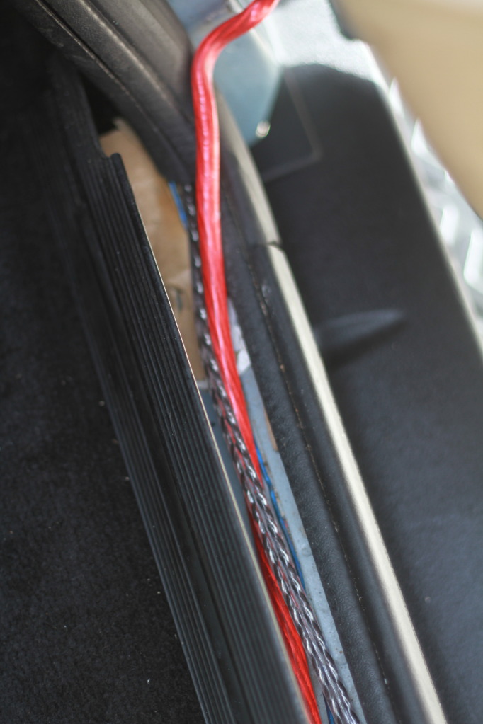

To run an after market sub/ amp setup in the back of your truck you'll need to run RCA and remote amp cutoff wire(blue) from your head unit to the back of your truck and a red power wire from your battery. I run the RCA and amp remote wire under the dash, glovebox (not the cleanest looking install, just the easiest for me), and down under the passenger side front and rear door sills. Accomplish this by just gentle snapping the sills upwards running your wires under it.

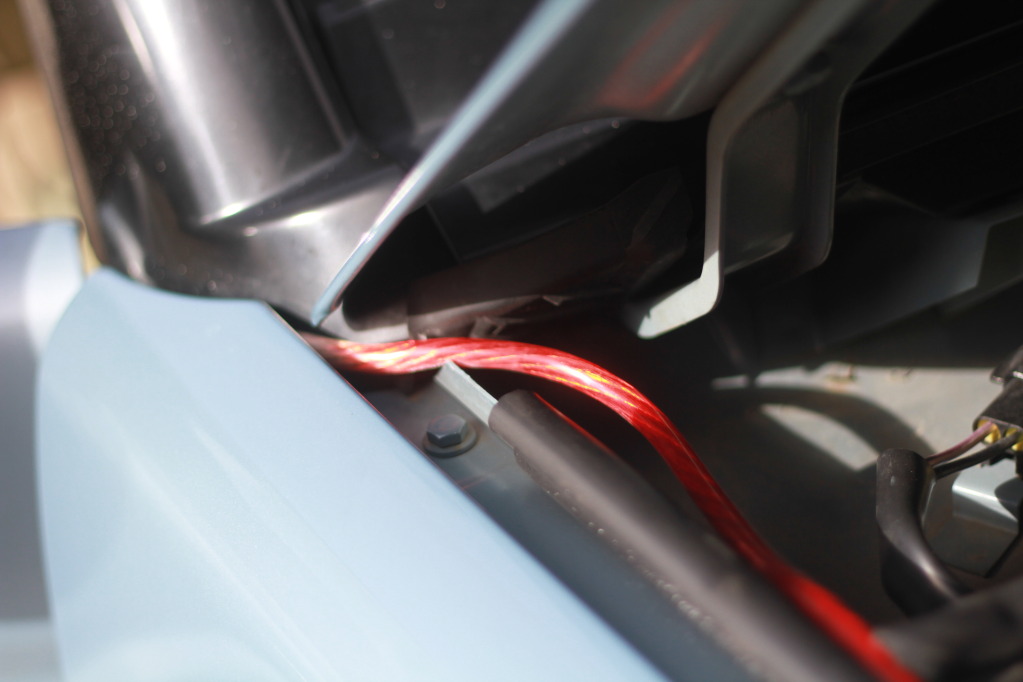

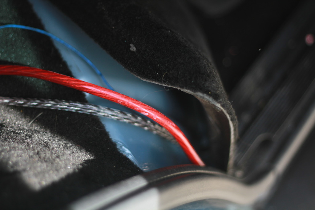

While you have your door sills off you should also run your power cable from your battery. Normally you would want to drill a hole in your firewall and snake it in that way...however i didn't feel like hitting anything of importance so i ran it along the hood seam and door jam.Which when the doors are close are completely hidden.

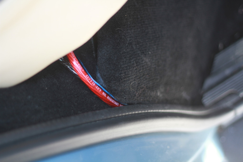

Run all the RCA, Amp, and Power wires along the front and rear door sills and gentle remove part of the carpet in front of the rear seats and snake them behind and up.

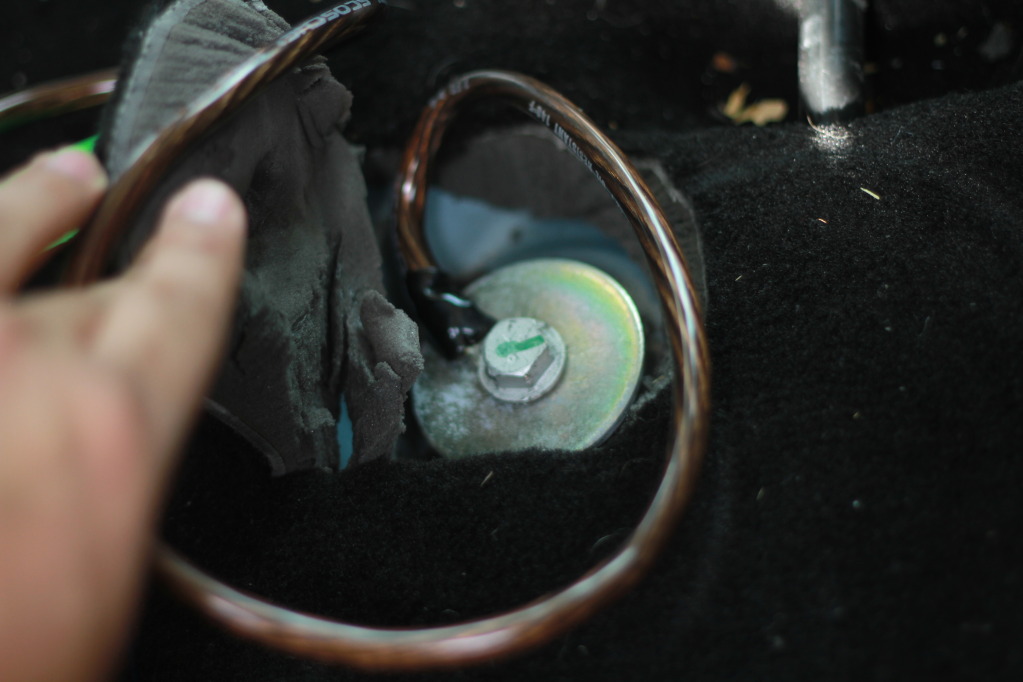

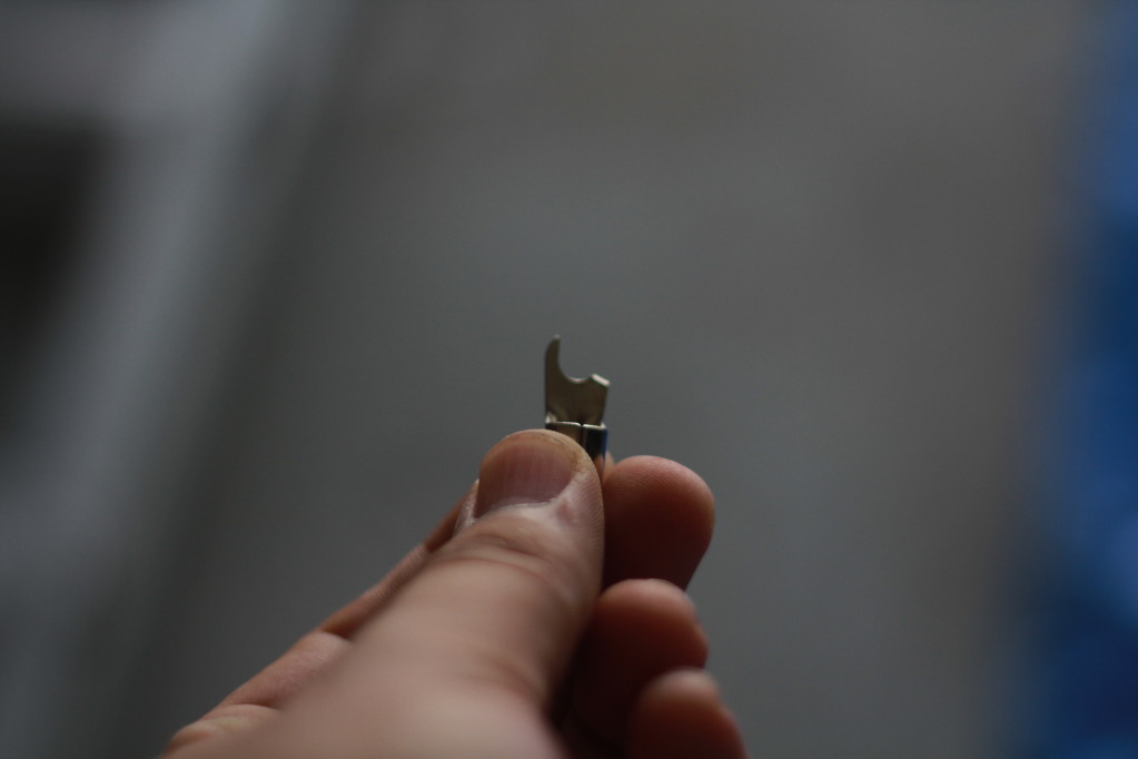

Now that all your wires should be in the rear of your Rover. I loosened this bolt in the rear cargo area under the carpet slit slightly and snipped one of the ground connector prong to sit securely when the bolt is torqued down to serve as a ground.

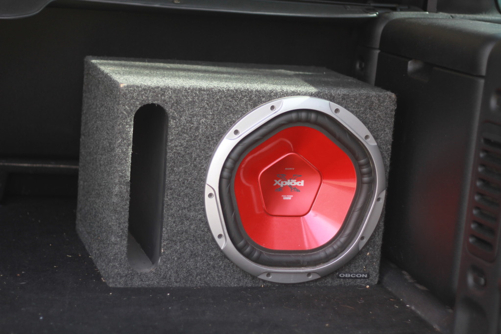

Then connect all the wires to your amplifier. And wire you sub box. And you're done.
