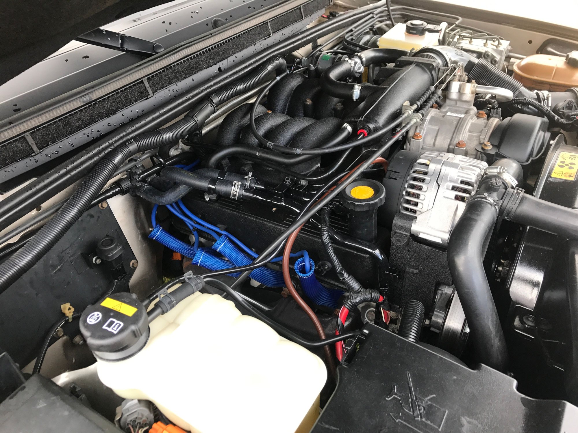

Yea I like my kingsborne a and I also went with the covers for the plug boots i also did a set of new magnaflow y pipes just since I was redoing everything
...that's a nice looking engine, looks nice all treated in black, awesome; and I see no SAI, those are a pain! ...hope mine looked like that.
I may go with the yellow wires this time around, and yup, the boots gives them an added protection, but now I just want the fault to go away... been using wifey's car and don't think she might fancy me taking it from her this coming week.
BTW, Champion Platinum, or Double Platinum, what are you using?

Thanks. I had everything powdercoated and the rest that was high heat was cermanic coated including the y pipes to try to help keep heat off the front drive shaft. I went with the champion platinum. I don't know what kind of mileage u have but I would reccomend the front o2 sensors for sure. I got the walker's off of rock auto with shipping for a little over $100. Everybody kept buying Bosch ones and kept getting faulty ones. I read somewhere in the forums where the folks across the pond replace theirs with walkers when the go out and I can tell why. I haven't had any issues......knock on wood!!
