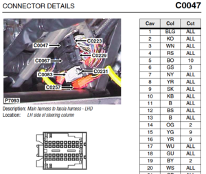

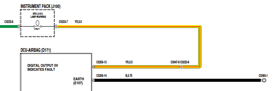

Here are screenshots. The circuit diagram shows the circuit going through connector C0047, and the electrical library shows C0047 among others on the left-hand side of the steering column. From there it goes to C0233, which is one of the two big connectors at the back of the instrument cluster.
But like you, I don't understand why you get a code for a light circuit when the light circuit clearly works. Perhaps there's an electrical wizard reading this who will have an idea or two.
Attached Thumbnails SRS light fix?-srs-light-circuit.png   SRS light fix?-connector-c0047.png
