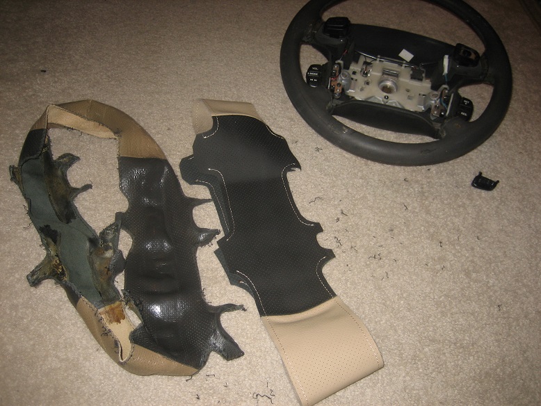

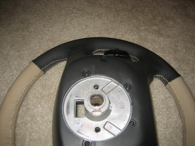

So, here is the full story. My disco had a hole at the 12 position on the wheel, which was overly nasty. I contacted a company that I had worked with before, Redline leather, and inquired about having them make a cover. While they were making a template, I found a great condition wheel at a breaker yard. Anyhow, the new leather arrived, and I began the tear down, and just finished the new leather all put on. I am sending them a DIY that they will put up on their webpage, but I figured I would post some pics on here, to show the highlights. This first pic shows the cover being removed, then old and new covers with the wheel with no cover, the cover loose on, then the new cover. It is really soft leather, I have a great one on it now, so I might end up selling this one, but its a good option for those who want to fix their nasty wheel.
I mostly wanted to let people know this option is now available for our discos. This black perforated leather and sierra, it is about as close as possible to the original colors. The black is right on with the stock wheel, the sierra is just a hint lighter. Once the disco is back home, I will update this with it next to the factory one. I suppose a person could forgo the two color and just do the black perforated.
Mostly after working with them on this new deign, we have options.

I did nothing after stripping off the old leather. around the "legs" needs to be glued, I used some stuff I got off Amazon made by Aleene's Original called Leather & Suede Glue. The glue goes through the perforations, but this type of glue just rubs off the outside so don't be concerned about that. Redline includes heavy duty string for stitching it, and they include a lot of it, probably to do 1.75 wheels with the stitching pattern I did. The only complaint I had was they included a thick needle for stitching it, and the needle could have been sharper, that would have helped a lot.
Overall the leather from them is a lot softer than the factory leather, it has almost a calfskin type feel to it, I have a great condition OEM one in my rover now and I am even considering taking it out and putting this one in since it feels so much better
