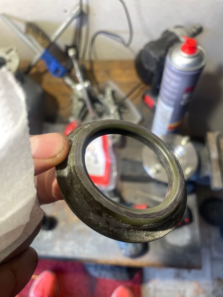

Hi All,
Checked front shaft, wasn't it. I did however find the source of the noise after taking out the transfer case output shaft bearings.
The front mud shield had deformed and was loose, periodically spinning with the output shaft and grabbing onto the seal. You can see how the shield has been damaged from the grinding.
Really nice to have found the source as it was driving me nuts!
Hopefully someone in the future can find this thread and find the issue quicker.
