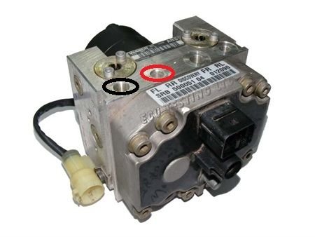

Good day,
Anybody know the thread size of the ABS module? I stripped one out good. Have replacement on way from Kentucky, but was thinking I could tap and put in a permacoil to fix. Just need to know size. Stole this from someone else that didn't get reply yet. Thanks

Is that where the hydraulic lines go in? It needs to have a tapered seat for the line to seal against. You wont be able to drill it out or modify it and keep the seal
