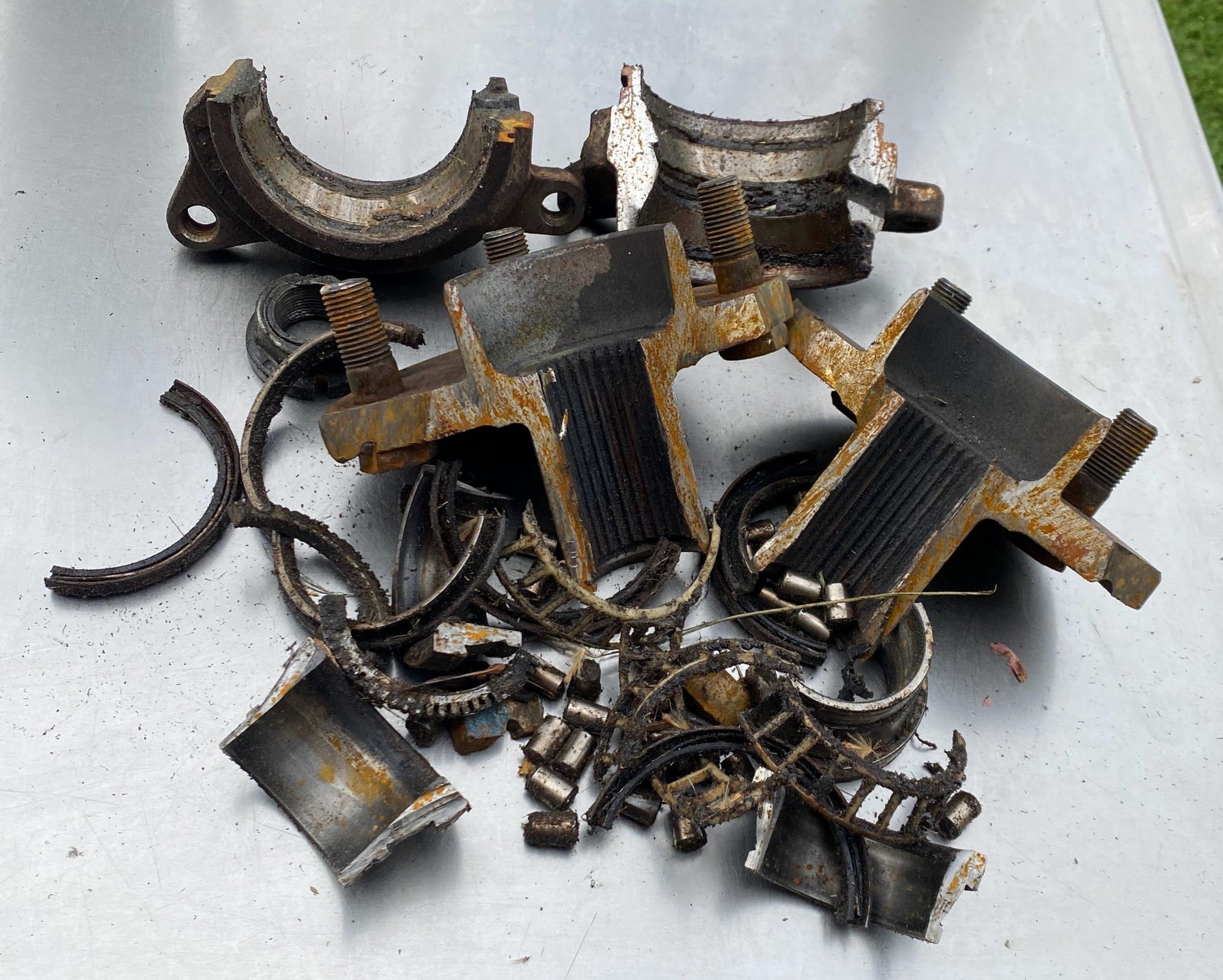

Needed a front hub replacement on Jackie, 247k on original front hub so not too bad. Despite living its entire life in the carolinas, hub was stuck on the axle. First I tried gently tapping it out like usually works (chucked up in vise), then I took it to two local shops to use their press, 1st one was a smallish press, 2nd one was more like a 500t - still didn't budge. Took it home and broke out the 8" grinder (I needed quick because ROAV event the following weekend). Took about 20 minutes to cut through it. Thought I would post the solution in case anyone else came up against a stuck one.
BTW, the rust is because after cutting it off I left it outside in the rain overnight.

I know I would have messed up the axle splines good on you for nailing it

Once it was down to the last few thousandths I basically wailed on it with a hammer to break it in two - more broke than cut.

Nice cut though. Quite clean!
If it makes you feel any better I had to saw a lower ball joint in half once. That didnt go nearly as well as your surgery here.
