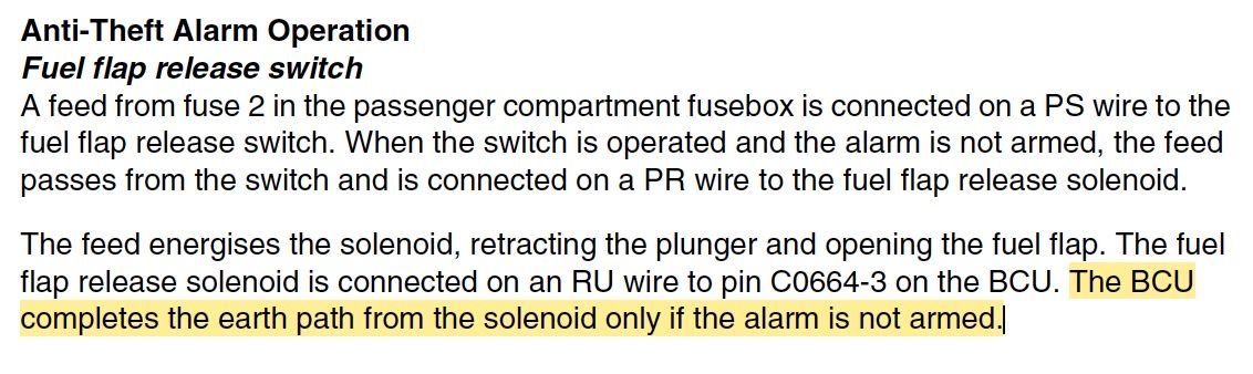

Does the fuel flap cause a mislock alarm if it's open?
When I was doing a little research yesterday for this topic, I found this reference in the RAVE Electrical Library.
There were no other references in the Electrical Circuits PDF or the Workshop Manual about the fuel flap being an input to the alarm system. The BCU uses alarm systems to include disabling the fuel flap solenoid as an output.
