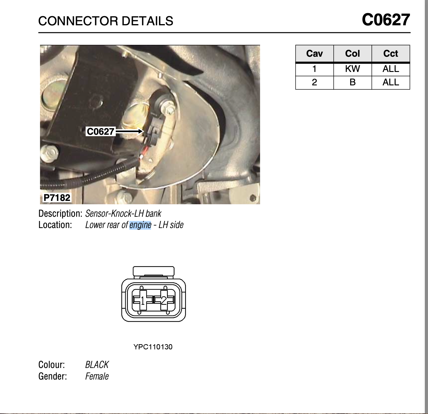

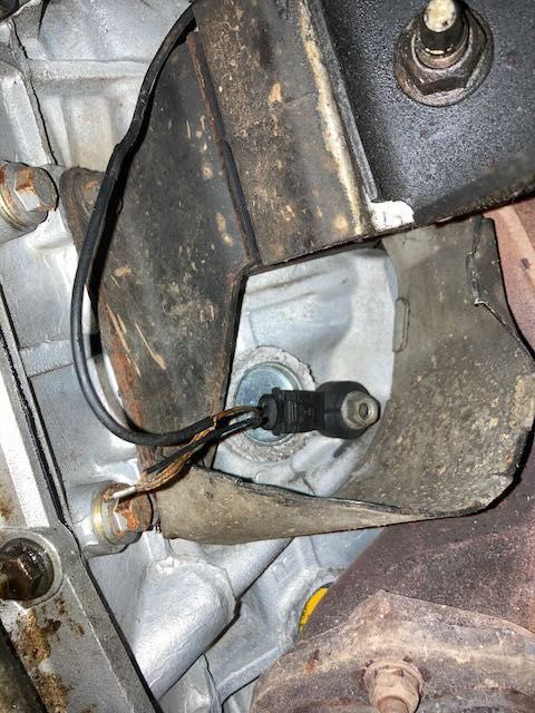

I did find this strange wire splice under the car to the back of the engine block, plugged into what looks like a sensor I'm not familiar with. Is that just a ground connection? The wires were tied together with electrical tape (which I removed) and the wire flops around under there in a way that's definitely not factory specified.

Found my own answer to the strange wiring — it's a knock sensor, as shown in the electrical library. Forgot that the mechanic replaced the knock sensor for me and the replacement didn't come with any pigtail so they had to wire in to it. So that's a scratch on being a cause of all these other codes I think...
