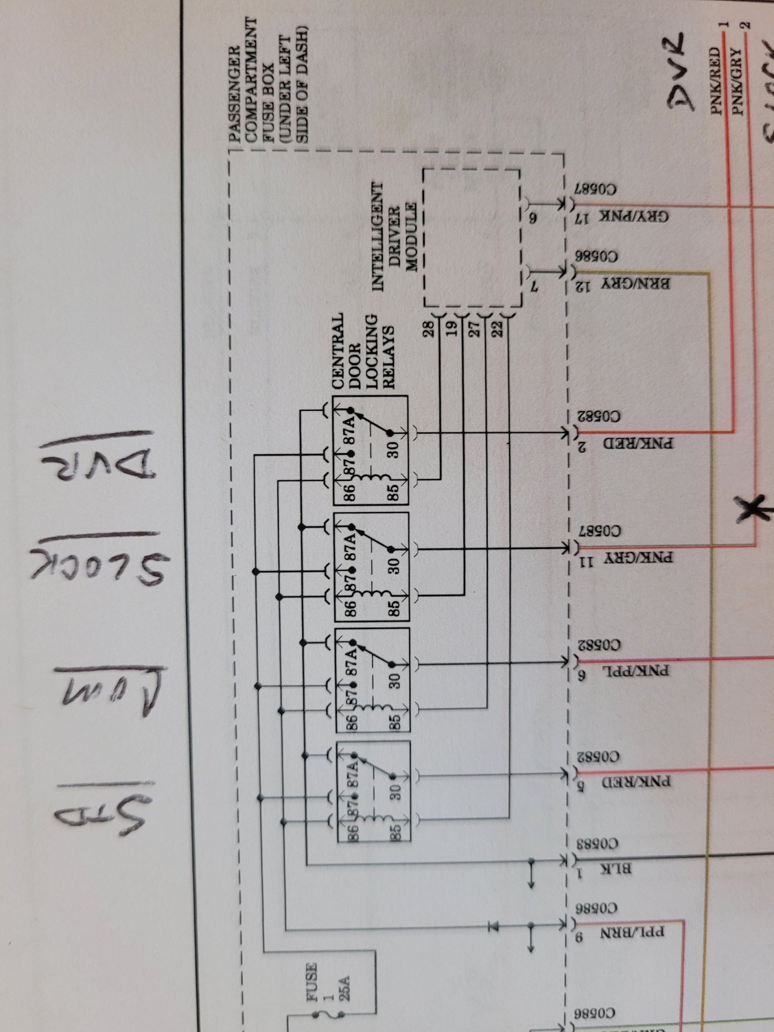

Thanks for the idea AKJOHN, but I'm not seeing any relays mentioned in the wiring diagram related to Central Locking? Am I missing something?

Here is a diagram of the relays. They are controlled by the IDM (intelligent driver module). Where are all of the intelligent drivers when you need one ? Ha!
It is possible to pull the connectors from the fuse block and carefully test each door actuator manually. I did this with mine and found the doors worked perfect. So my problem was with the relay control. In my case, the unlock relay was stuck.
Fuse block relay schematic
