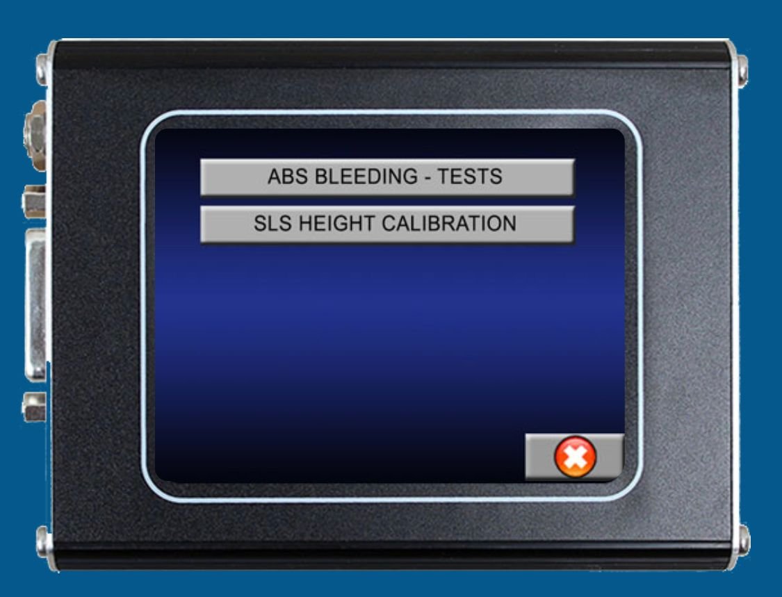

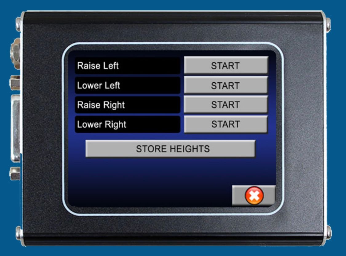

After you correct your droopy suspension airbag issue, you’ll have to recalibrate the SLS system with a Nanocom to correctly set the ride height.
