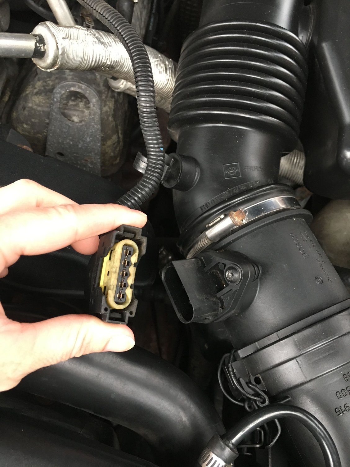

Also it would help me greatly if I knew wth this one exactly was. A Land Rover repair only shop in a city down here told me it was a discovery II bc my title doesn’t say that but I just checked vin and I’m getting Discovery HSE 4.6 liter I also ran into online asking me if 6 4.6 or 4 4.6 and I honestly don’t know but attached is pic to make sure I am answering the pin connect correctly cause you ask 3 or 4 and I count 5 🤷*♀️
I also just found some bad and or missing fuses so need to take care of that and there was a 30 where a 40 should be
