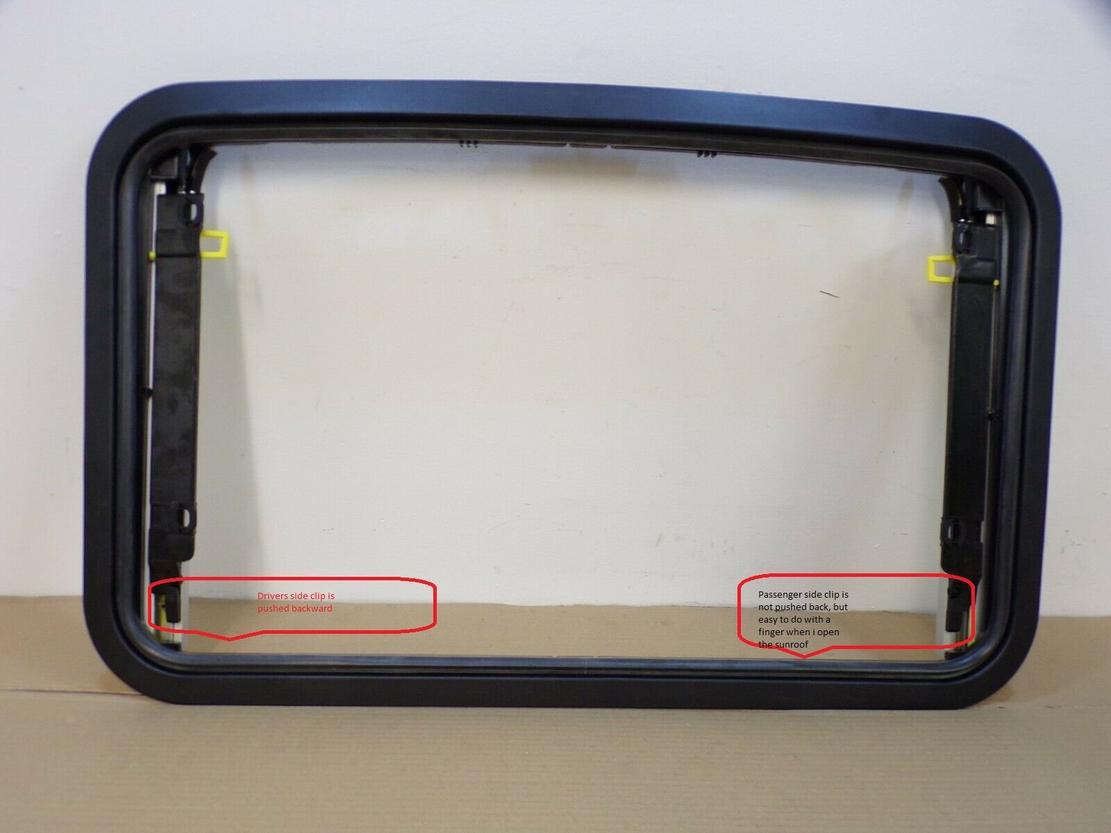

Hi, an update;
I thought the front sunroof was open like it should, but there is a problem with the passenger side.
The little plastic clip that puls down the sunroof to close it completely is 9 out of 10 times not being pushed back.
This causes that the drivers side is pushed up but the passenger side is still ' locked'.
When I open the sunroof and push the little plastic clip back by hand (goes very easy), the window opens like it should.
I've got my old sunroof rails still here, but I cannot find the piece that pushes the little plastic clip backwards so the window can open.
Who's got some tips for me? I've searched the internet but can't find anything useful, probably because I don't know what to look for.

Hi its the worm drive that pushes the hook back, when I did mine it was like yours misaligned , and when I tried to open the sunroof you could see it twist to on side a jam up, for me the solution was to take it apart oil the worm gears , reassemble it making sure the hooks are in the same place and equal, then I fitted a replacement drive , mine is manual, so easy to do, my original was broken the gear teeth worn
just make sure the hooks are aligned before you refit the drive,

Hi,
With the worm drive you mean the teeth on the motor and the cable it drives? If so, then these seem to work like it should.
From the moment i want to open the sunroof both 'pins' are being pushed back at the same time and the same lenght, by 'pins' i mean these;
Also when i close the sunroof these 'pins' are both going fully to the closed position.
Since it's easy to push the plastic 'clip' backwards i think something else is going on;
Should there be something in the runners that pushes the plastic 'clip' back?
