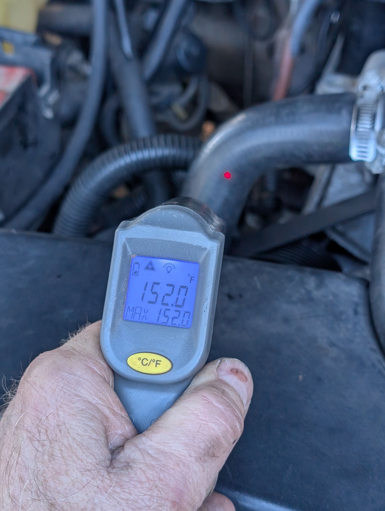

I replaced the temperature sensor and I'm still getting very conflicting numbers? The engine doesn't feel overly hot and taking various readings with an IR gun shows that. But the digital ultra gauge readings show very high temps? Have you heard of this regarding the ultra gauge displays before? I have pressure tested the cooling system, it holds pressure easily for 20 minutes with no significant loss. I'd rather not keeping throwing parts at it Any other suggestions before I proceed? Does the ultra gauge need calibration?

Sorry, been away from the office for a bit. I think you still probably have a bad sensor. If your engine was that hot the IR gun woudl show it. BTW, best places to shoot for IR temp confirmation are the intake manifold discharge pipe (which you did), intake manifold crossover (where pipe attaches and factory sensor is located), oil pan, block external by motormounts (water jackets), and for radiator diagnosis inlet and outlet hoses.

I took more temperature readings. This time on the block itself with an IR gun. It ranged from 170 to highest 188 toward the rear. Pointing it directly at the cylinder jackets. Ultra gauge telling me it's over 220? I'm going to fit inline tonight and see if happens.

Have you replaced the sensor yet? You said that you got a normal reading shooting the boss where the temp sensor mounts while the UG showed 230. That says you replace the sensor.
