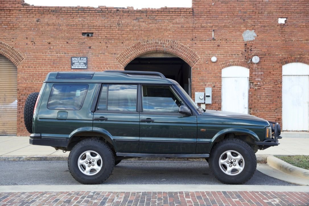

RTE or bust. You can order 2” fronts and 3” rears, or 3” fronts and 4” rears. Always better to lift with spring only rather than adding spacers.
you’ll need longer shocks for the rear than OME has though. You’ll want 10” travel bilsteins or fox shocks I believe. I had fox 2.0s remote reservoirs when I did a 2” lift with 1” in the rear. It’s a good look.
he is my old truck set up that way:

Dude! I love this!,,

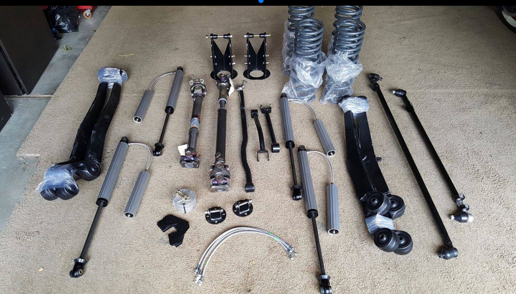

I haven’t called RTE yet but I did bang around on their website. Saw this full lift kit option. Looks like It offers everything you need without having to piecemeal it all together. I’m very excited about this option! I appreciate the heads up!!

Called and talked to Simon. VERY helpful guy! His system is pricey but I think it’ll be totally worth it! Nice stuff!
